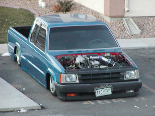

New member here from Colorado with a build i think u guys might be interested in and be able to help me out with.
a couple of pics from throughout the build so far since i have owned the truck.
bought it stock a little over 2 years ago..
progress..

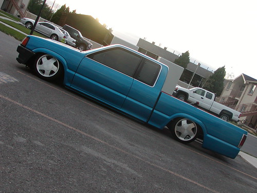

first bagged on chevy z71 wheels and painted infinity g35 blue
then body dropped it to the rocker(yes i cut off the pinch and it lays body)
lays hard...

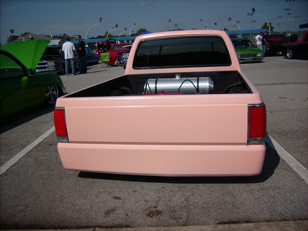

then sealed with a tinted pink sealer for a sparks in the ozarks in bentonville arkansas( was supposed to be temporary but u know how that goes)
all shaved. no gas door, no tailgate, smooth roll pan...

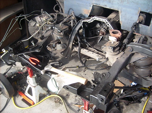

and the beginning of tear down..

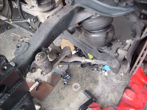

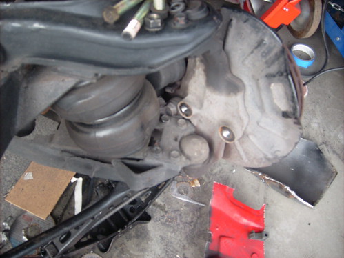

its bagged on all four corners with Slam re7's, parker valves front back side to side. bodydropped 3 1/2 inches to the rocker. its got 08 escalade wheels on it right now and a custom back half with modified stock upper a arms.
its got a 10 gallon tank and a viair compressor with a spun aluminum fuel cell.

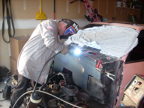

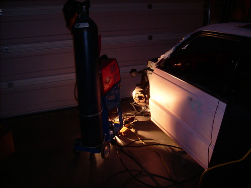

and just a cool shot with the welder and my truck..
late night welding session.
just waiting on my trailer fenders and gotta remove the whole cab to weld into the tranny tunnel. then i have to cut a hole for the steering column and mount my brakes and clutch and gas pedal and clean and paint a few things, then the engine will go back in for the time being and maybe get a coat of paint on her by time for FFF in march.

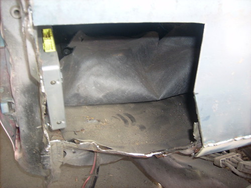

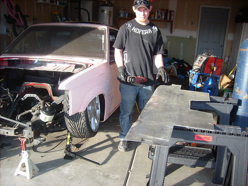

So weather permitting i finally got to tackle a few things i have been needing to get done that have been holding up putting the engine back in.
My plan was to tub the firewall to fit 20's and get my steering figured out...

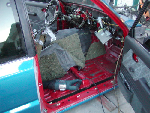

i also have started a RHD conversion but i believe i am going to have to convert my whole steering since i cant figure a way to get my factory steering box to work with my frame. But thats neither here nor there.

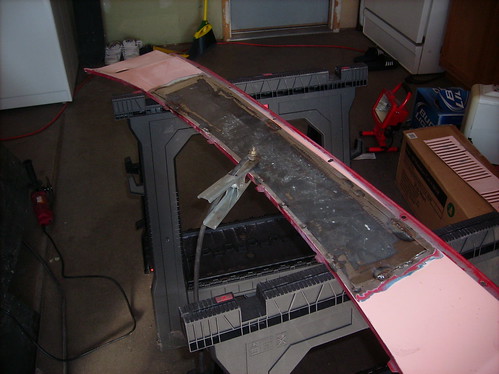

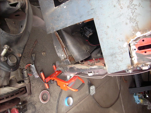

flap disced some paint off to fix the rear skin that i drug off and welded her back up. just need to do a little filler and hammer and dolly to bring it back to true..
heres the hole for the steering b4 i decided i was going to go ahead and do rhd..
it just metal, no worries

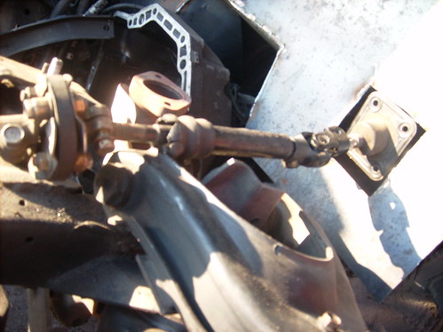

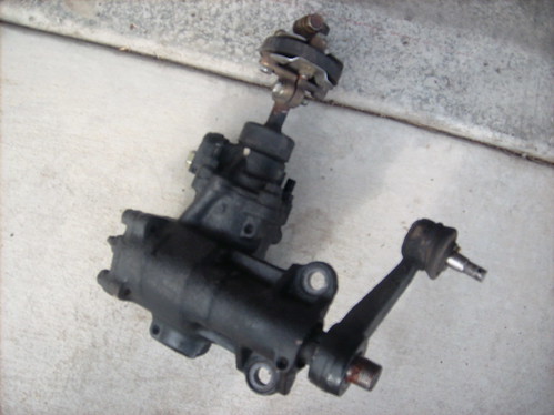

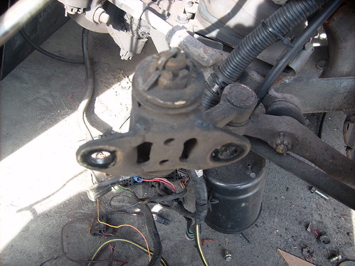

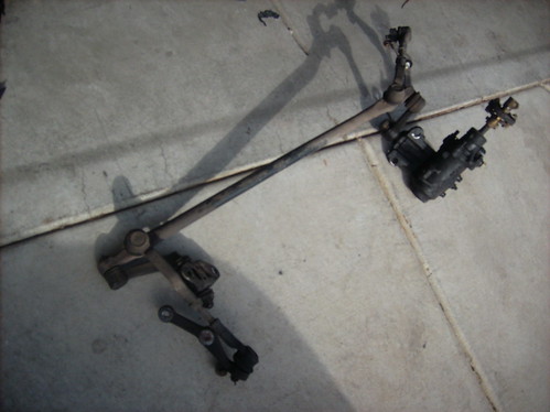

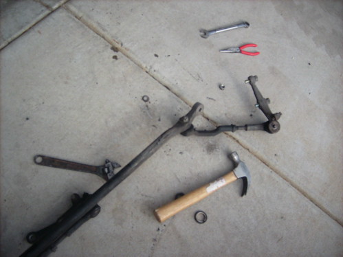

heres the process for swapping from usdm steering to rhd using the stock linkage...

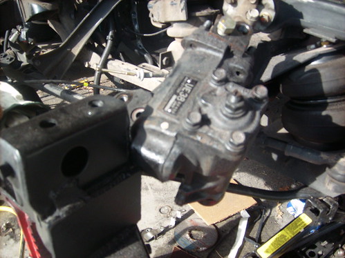

now if only i can figure out a steering box or i am thinking of going with a tacoma steering since i am planning on going 5 lug anyway. but the point is, that this can be done just flipping the stock components..
bye bye ugly ass steering box..
unbolt the whole linkage and flip it
now all u have to do is pull some cotter pins and take off some crown nuts and make it all fit lol :shock:
man that thing is big and ugly.. glad itll never be used again on this truck..

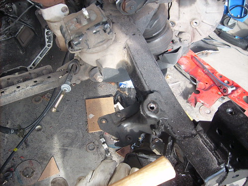

well that would almost work, except not...
gotta move some things to the back to clear for the up and downness(is that a word?)

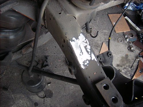

shaved some useless brackets off the frame to mount the steering box.. now i just have to find a steering box to work or like i said just change it out for a completely different setup, but like i said, this can be made to work..
i thought i was going to have to swap sides for the flip, but these stay...

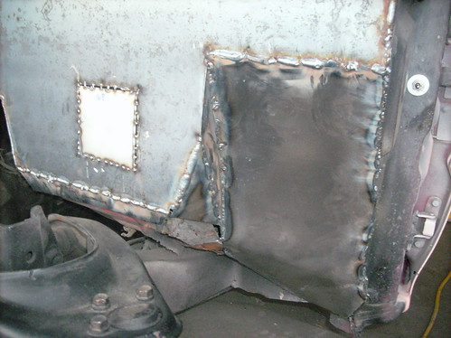

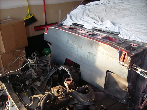

i think that'll tuck 20's, now lets cap it in and tub it...

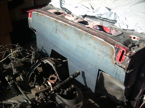

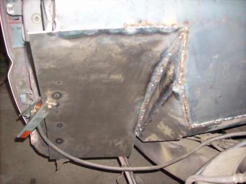

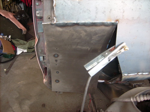

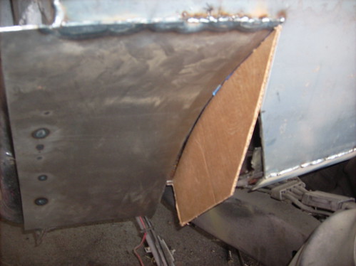

the batteries died in the camera so no actual progress pics, but this is what i did:

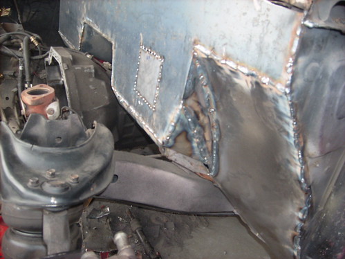

i used 18 gauge for the tubs because its more maleable than the 16 ga. i used for the firewall.
i cut out a piece that was 10 inches wide for overlap and 19 inches long so i could mold it into the bottom side of the cab.
then i tacked it in a few places starting at the top and worked down trying to weld on the back side for a cleaner looking weld and less grinding.
then i used some cardboard and traced out the arch and the flat edge of the firewall to build filler pieces.
i wanted more shape to these than just flat so i cut a triangular piece to tie it all together...
here is the finished product all welded up. it was kinda pointless, since none of this will be seen when its all said and done, but i know its there, and that its done right..

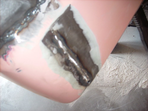

also notice the filled hole in the firewall just stitch welded as to not warp the sheetmetal..
i had to figure out a way to tie the bottom of the firewall back to the stock sheetmetal for that clean look and also for rigidity and to seal the whole thing up tight so i scored the metal with a cutoff wheel and bent it back...
and welded in..

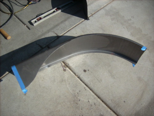

and heres my inner fender concept that i have never seen done b4 with a tandem trailer fender. 8 inches off the bottom and cut in half. now it just needs 5 inches sectioned out of it and brought all back together then they can be welded in also and boxed into my fenders...
making sure everything still lines up and getting measurements for my inner fender tubs..
now thats fitment... just wait till im tuckin 20's :cool:

if anyone has any idea on a steering box or thinks i am missing something, please feel free to let me know..

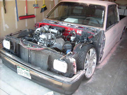

well i sold my engine to a buddy so as of right now i am looking for either a s4 s5 or 13btt rotary swap since i am being forced into going headfirst into this rotary thing lol.
if anyone knows any good sites for mazda engines hit me up or if anyone has a 20b cheap i would love u forever...

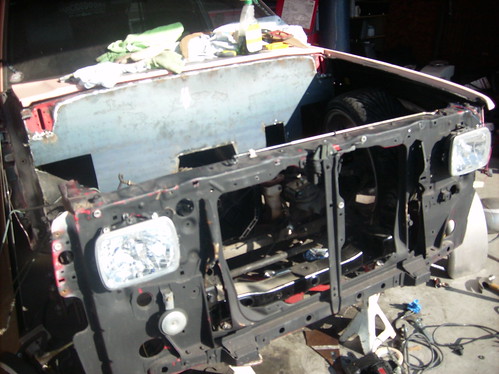

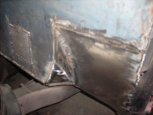

alright, well i got a bit done today. im getting down to final details on this firewall project and we all know the little s*** is what takes the most time. and there was not enough beer or time today to get it all done, but i did make some headway.
on to pics and hopefully the last things i have to do to this firewall b4 i mount my steering and my brakes, clutch and gas pedals..

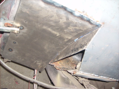

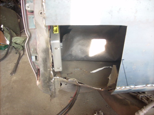

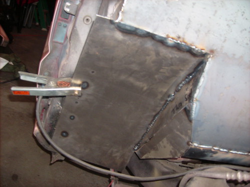

ok, so i had already tubbed the old driver side(now the passenger side, yay) so i needed to tub the new driver side and make it work to have enough room for all the pedals, which seems easy, but its not when running big wheels..
so i really didnt want to tackle this project. probably the reason i left it for last..
anywho, heres how i did it, if anyone wants to lay out on 20's or bigger on ur civic, heres how u can do it too lol..

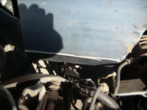

alright, so first u will want to cut out the existing sheetmetal. in my case, this truck had already been tubbed for 18's before and i really didnt like the way that we had done it. it was pretty half assed imo.
now i needed to trim the edge so i can turn corners when im laid out driving so i dont puncture my tires, so i took some out of it to match the other side and try to keep these things looking as close to the same as possible..
then i put my wheel on and jacked up the suspension to check clearance. i overcompensated from my 18's with a tire to make sure a 20 with a tire will fit without any rubbing issues. then i cut out a piece of 16 ga. sheetmetal again 10"x20" and bent it over my knee and tacked it into place. whatever excess u have will later be trimmed off with a cutoff wheel or a plasma or whatever u have to get the job done..
cradboard is a sheetmetal guys' best friend. i use it to make templates b4 i cut the metal out. so much easier and cheaper to fix cardboard than sheetmetal.
always measure and check s*** out a few times before actually cutting the metal out. and cut big. metal an always be trimmed down.

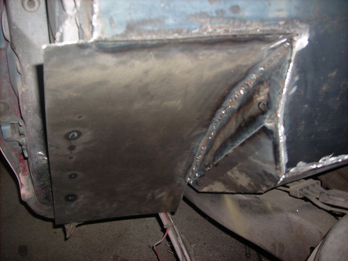

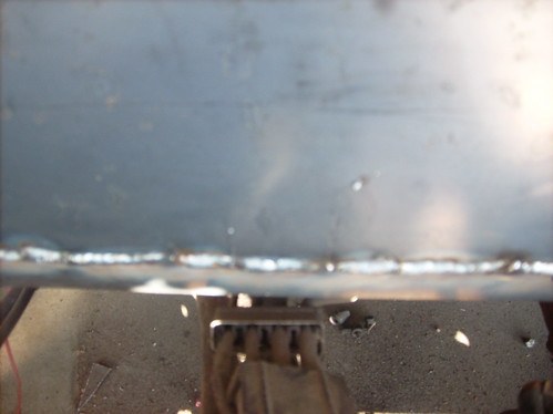

i try to weld everything up from the inside, and i use the stitch welding method on a lot of these tubs. a lot of people will say that stitch welding is bad or whatever, but i figure that this isnt a very structural part of the vehicle, so as long as it sticks to the other metal, and i carry a few beads for rigidity it will be sufficient..
this also makes it easier to grind down and keep cleaner and i can put my seam sealer on the indide of the truck to keep things cleaner down the road. even though nobody will ever see these unless they get down on their hands and knees and look, but s*** like this is important to me.
good labeling will save u a lot of grief. a lot of these littler pieces can get sonfusing if u cut more than one at a time, so an easy number or this side up mark will make it easier.
here it is tacked into place. just need one more piece and then u can weld it all up tight.
here it is all tacked into place. now u can go to town welding it up water tight.
now after i relocate a few things like my ecu, i will be able to mount my pedals and cut a hole in the firewall to mount my steering column.
here it is all welded up. i welded from the inside of the can and then ran a few stitch welds on the outside to fill holes and things. also there were a few places that the grinder wouldnt be able to reach, so i filled these spots with a weld to help with he smoothing process..
now on to the grinding. this is what takes forever and is loud and looks completely different the next day when ur sober..
passenger side gorund down and ready for filler..
driver side ground down and ready for filler. i was more successful in welding from inside the cab on the passenger side, so there was less grinding, and will be less filler. the finished product looks a lot smoother and took a lot less time in the long run.
now i just have to finish grinding the rest of my welds and get ready to fit my inner fenders. also i have to tuck the rest of the driver side tub to the bottom of the cab and trim the excess and weld that, but the extent of the big work is done..

ya, i am at a complete standstill until i get my engine in, and i wont order it for a couple more weeks: taxes. u know that old chestnut. lol.
i am planning on doing some body work and relocating some wiring and such and repainting a few things.
i have a big show in cali in march and the truck will probably go rolling chassis to it, so no rush really.
idk, it just eats at me that its just sitting and wants to be driven so badly and i have so many parts just waiting to be mocked up.
but it is on the ground again laid out with the full front end on, so like i siad, i need an engine badly..
