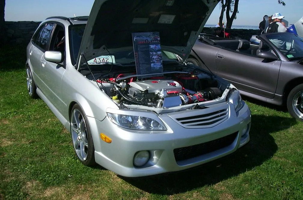

i'd say it's worth if you have the money, expect some issues since you have now modified the car.....i have an auto p5 and it's not the same car...i have the MAM sleeper kit and it has made this a whole new driving experience!! oh, and at 5psi it's probably pushing 160...i'm going to get it on the dyno this spring.
