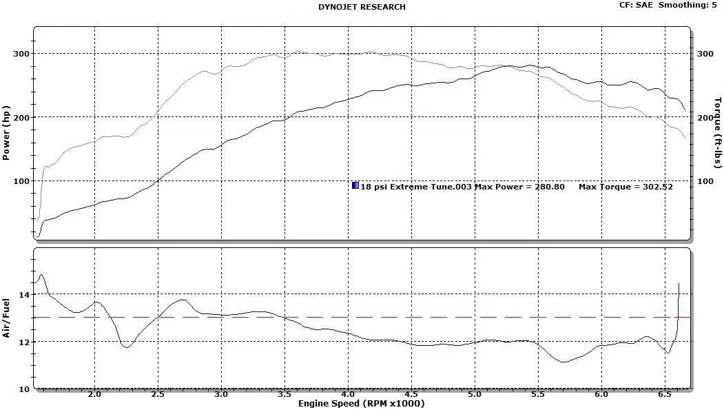

Tuner said exactly the same thing and suggested I get water/meth. I've got the cp-e pump and I'm tuning again this Friday. Hoping for good things.
So as you guys know i'm pretty much on the fore front of modding for the ms3. So i decided to finally be true to myself, get the car tuned and call it a day.(or completely be done modding the car for performance) Any ways so first pull i get 274 whp and 298 ft lbs. I'm thinking to myself"wow thats kinda low, i know people are posting higher numbers with fewer mods". So the tuner starts working his tuner magic, and my wonderful experiance turn'd bad fast. To make a long story short,..., my a/f were low on the bottom and good up top, no surprise right. Well to tuner guy can't tune the car at all. Im already maxing out the pump down low. He basically told me not to drive to car hard till i get a fuel pump. So i called cp-e and su to help and both of those guys were great Mark, and Jordan. They helped out alot but i still have my hands tied behind my back. I was on the dyno for 4 hrs they were trying all kind of things. I think the tuner guy felt bad so he only charged me 100.00 and told me to come back!!!!!!
I knew the fuel pump issue was going to criple me but i didn't think it would completely halt the whole process. I guess this is what happens when your in front. I really thought i would be able to work my way around the damn fuel pump for some extra ponies!!!
