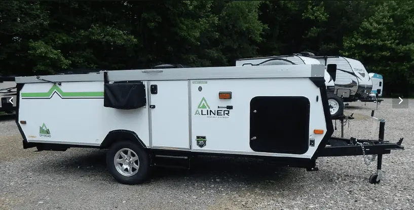

I own a 2016 CX-5 GT w/ 2.5 liter engine. Towing maximum is stated as 2000 lbs. I'm pondering getting a "lightweight" travel trailer. Specifically looking at the A-Liner models (Ranger 12 or Scout) that weigh in 1450 ~ 1395 lbs, respectively. Of course thats "Dry weight" with no add-ons, and gear. What's the opinion of the community on towing this much weight with my CX-5? What about packing gear in the car...does that not count as towing weight also? And what about getting a transmission cooler? (if there's such a thing) ~ Thank you.

Stuff packed in the car counts as cargo/towing weight. Can’t add a transmission cooler as there are no ATF lines running in or out of the transmission. The transmission fluid is cooled by the engine coolant running to and from the transmission itself.
Sounds doable with 2 people and no water in the storage tank. 4 people and cargo is going to be pushing it. I don’t think I’d be comfortable going across country but you should be good otherwise (staying under the weight limit).
Consider testing and changing your transmission fluid if you take up towing. It’s a “lifetime” fill for typical driving situations, but towing near max capacity changes things a bit.
I should add that the Aliner trailers have their own set of brakes. I was reading how breaking can put a ton (pun intended) of additional pressure on your car.
That’s good. That would give me peace of mind while driving. Much safer! : )
