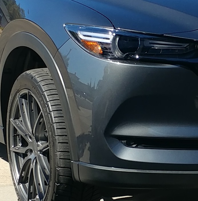

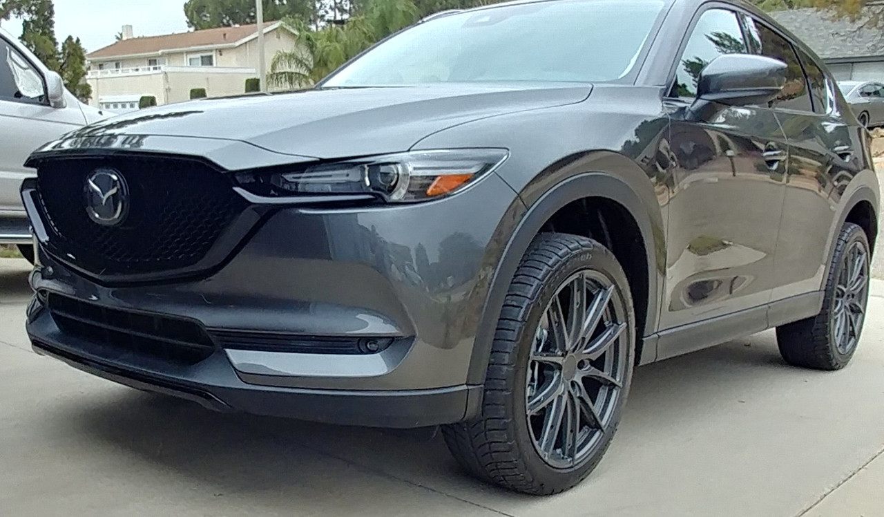

We had a new front bumper cover installed on our Machine Gray CX5 by a body shop I have used before with great results. The first paint job the body shop did was off (see pic below)
They were not happy at all with the outcome so they called PPG. PPG sent some "experts" to the shop and showed them how to mix and apply the Mazda multistage paint. The repaint came out 100% perfect. You may want to approach your body shop and see if they can get some assistance from PPG.
