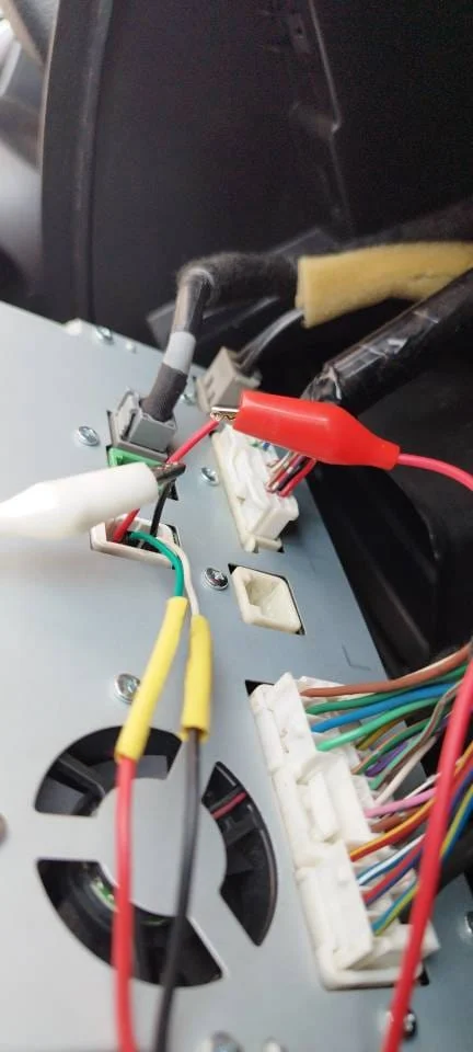

I tried installing an aftermarket front logo camera on a 2013 Mazda CX-5 (first generation). I tested several types (CVBS, AHD, PAL, etc.), all powered with 12 V, since the original output from the vehicle is 6 V and I didn’t use it during testing. In every case, the image on the OEM screen constantly flickers. I’d like to know if anyone has successfully installed a front camera on this model and solved the flickering issue while keeping compatibility with the original head unit. Any help is greatly appreciated!

I've been powering the cameras with the backup lights. All of these cameras are 12V. Although the multimedia unit has a 6V output, a step-up could be used to convert it to 12V. But I haven't tried this method. Video polarity issue + and - when I connect the opposite way on the screen no type of image appears, not even distorted. I also did another test by powering the rear OEM camera with a 6v adapter and connecting it to a TV, but I also didn't receive any image.
The idea was to have the TV indicate the type of signal with the input, whether it is NTSC or PAL, etc. But without success. I'm really frustrated, I want to solve this problem. I see on the Internet that they buy cameras and install them without any problem on the back, and these cameras are CVBS. I even bought several to know the result. But I wasn't successful. I don't want to change the multimedia unit.I thank everyone in advance for their support and help in solving this problem.
