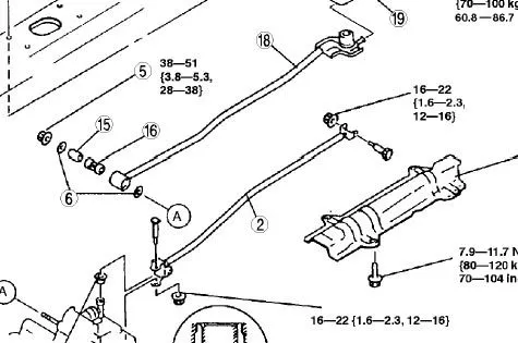

Thanks. Now from the looks of it appears we have "multiple" forks? Does anyone have a diagram of how the linkages are all set up? I haven't been underneath as yet (have Kartboy bushings on the way though)...
2 forks.
hyar you gho, picture attached.
I don't see any forks in that pic? The shift linkage yes, forks no. That pic looks like an external pic, you need an internal parts pic.
or that one just got cut off.
