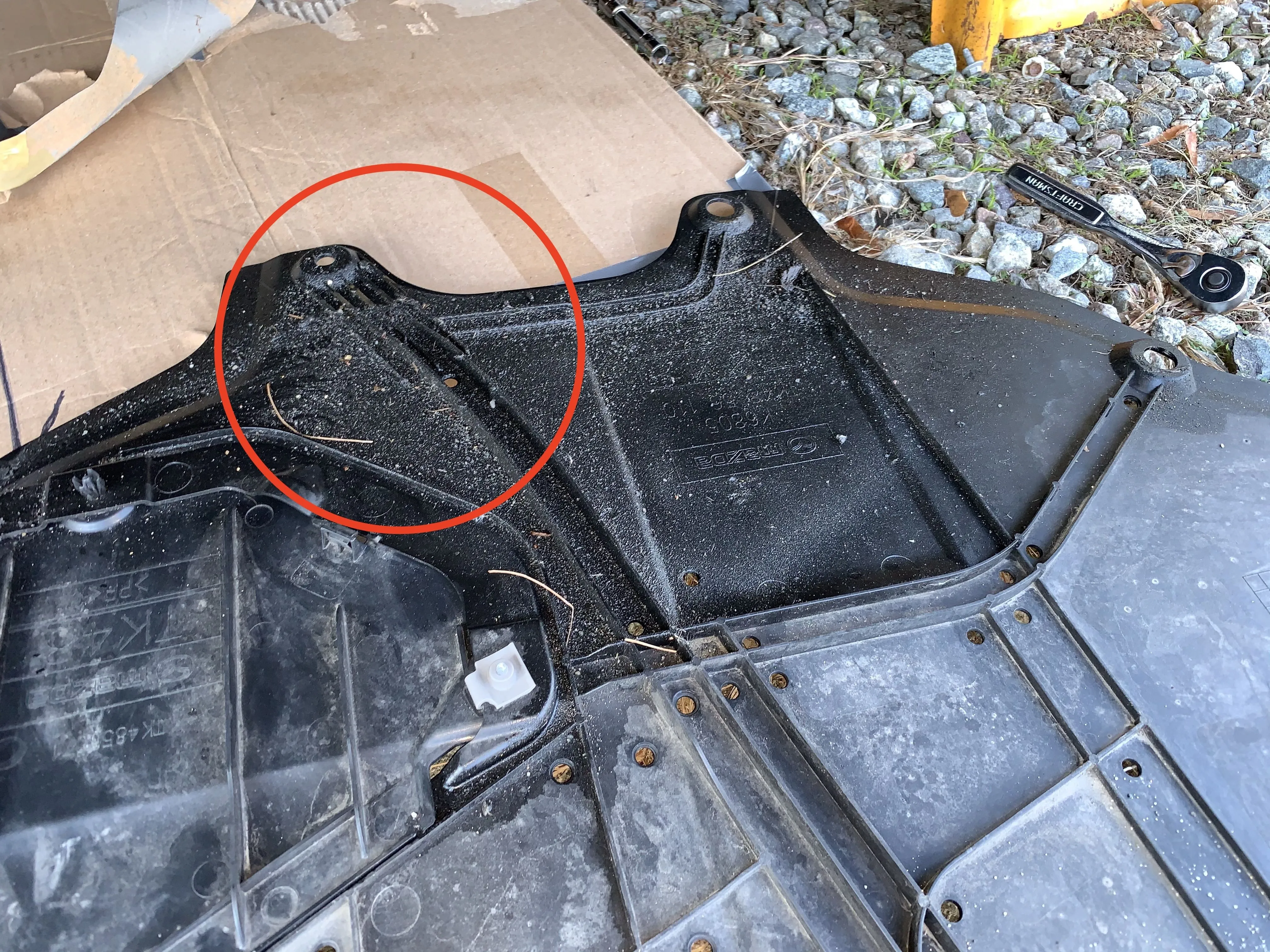

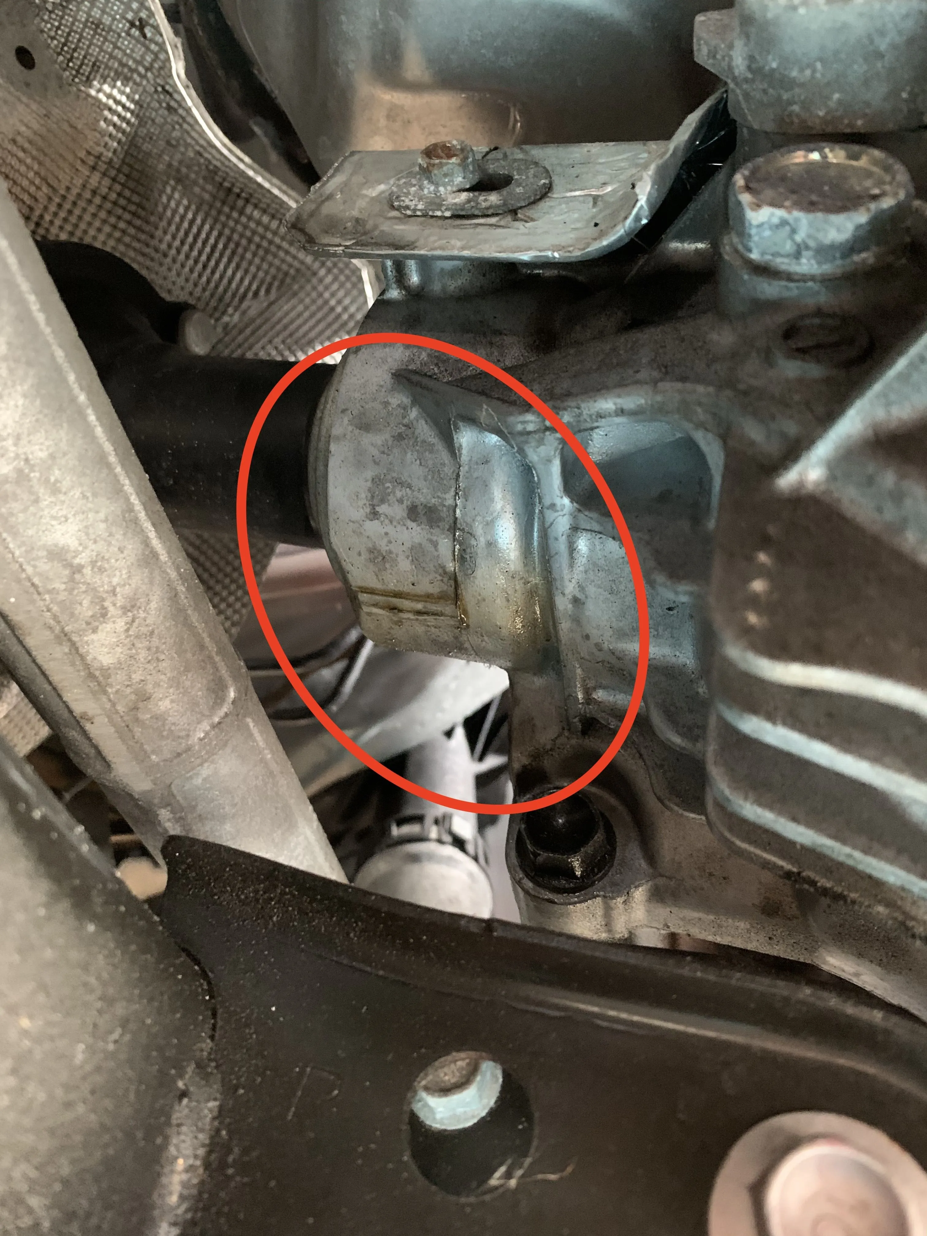

For a 2016.5 CX-5 2.5 AWD Auto transmission at 43000 miles, only owner . . . . . . In doing an oil change I had noticed a film of oil on the plastic cover under the engine. Pulled the cover off and there was definitely something leaking. It smells and feels like transmission fluid. Checked the motor oil pan and the area under the oil pan and def no leaks. The leak is shown in the attached pics. What kind of confuses me is that the Trans oil, from what I read, is blue, but this is a lighter colored oil (maybe dye wears off after a while?) and seems to be originating from the spot where the axle inserts into the transmission. The tranny pan and area around it and below it are bone dry.

The pic of the plastic protective cover was taken in November. Clearly the oil residue is visible. I dropped it yesterday and the oil was only in the red circle area (forgot to take a pic so it seems to have diminished but not entirely sure).
Pic of tranny shows where the leak seems to be originating from (no oil residue above this area, so not coming from above from what I can gather.

Leak is very slow I am guessing, never a wet spot under the car, and the other side of the plastic cover that faces outward was dry so not enough to seep out and drip to the ground etc. I only realized it in November because while changing the oil I was reaching in to grab a rock that had gotten in there and that's when my fingers touched the residue or else I may have never known.

By looking at the picture and your description the leak seems coming from the drive shaft seal on transaxle. It could be from front transfer case since you have an AWD.
You shoulld still have 5-year/60K-mile powertrain warranty on your 2016.5 CX-5. Take the CX-5 to your Mazda Dealer for warranty service ASAP.
