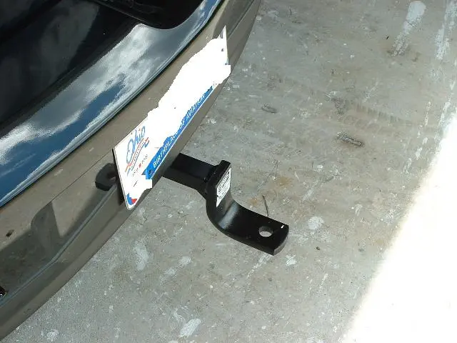

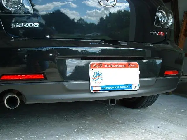

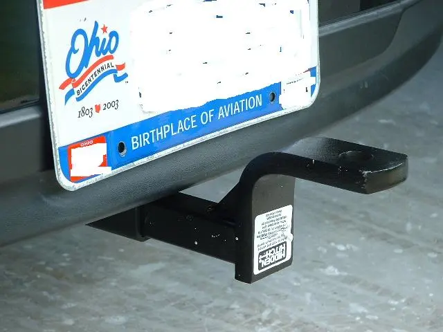

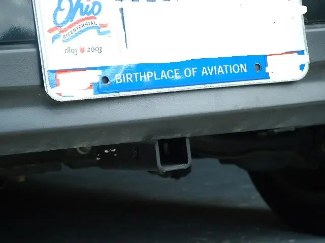

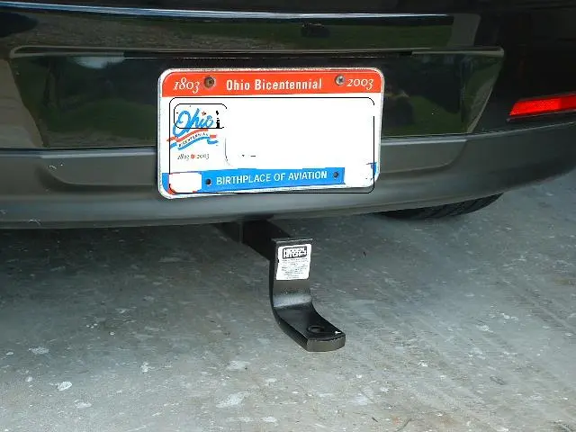

Hitch iinstalled
I got the Hidden Hitch from Etrailers.com about a week and a half ago, but just got time to install it last night. VERY happy with it. Perfect fit (literally). All you see is the small receiver box sticking out from under the bumper. Nothing else shows. Took about 1 hour to install on my own. Comes with 1-1/4" draw bar with a drop/ rise to it that fits pointing up as well as down, as well as the retaining pin. Need to buy a ball separately, and wiring kit.
Highly recommended based on the hitch fit and installation. ETrailers was great, too. Item arrived quickly, packed well, and without damage.
I haven't pulled with it yet, but hopefully it can handle a 4300 lb ski boat.
NOT!
Will be pulling a small, light trailer. Total of trailer and typical load should be about 800 lbs max.
