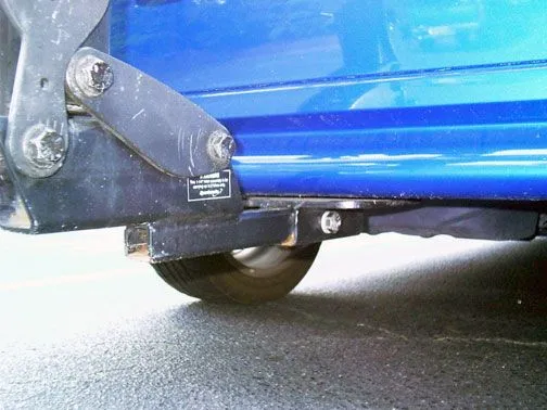

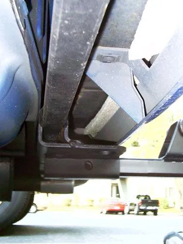

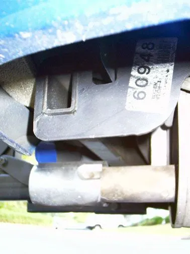

Pics of my installed Hidden Hitch. I forgot that you need to take the fuel evap canister (??) off as well. When my bike rack isn't attached it is all but invisible.

Nice install. Thanks for the pics. I've been going back and forth on whether or not I want to get a hitch.
Thanks,

its one of the easier things you can do with a ratchet wrench. I put on a class II hitch from eTrailer.com. Like the previous poster noted, the evap canister was a slight pain, there was not room to rebolt but its been wedged up there w/ friction for two years now with no issues. I've ordered several times from etrailer and their prices and shipping times have been great, but be prepared to touch up your hitch as there is usually a few scratches on them.

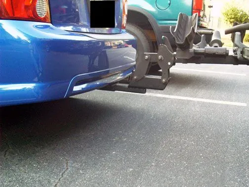

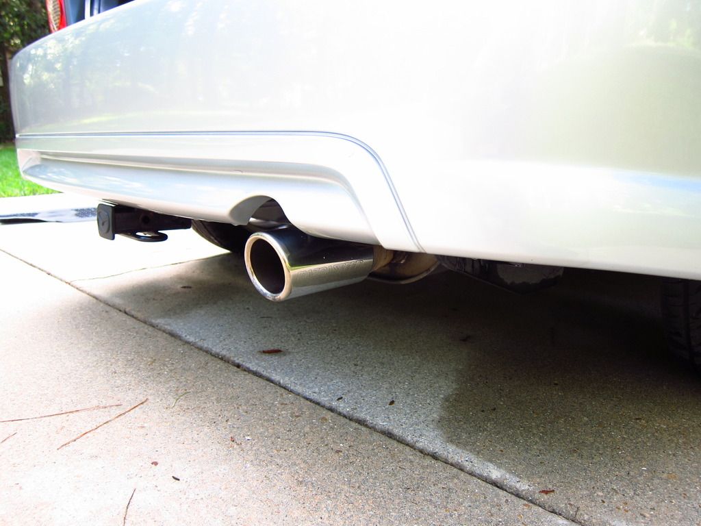

Here's the only pics I have of my P5 where you can see the hitch. It doesn't reduce the ground clearance all that much IMO. I've had my P5 for a year now and have never come close to scraping...even on steep entrances/exits.
Bump from the grave. Will the hitch fit with an aftermarket exhaust? I just bought a hitch and just to make sure when I go put it on, I have all new gaskets for my original exhaust should I to remove my cat back system. Thanks
