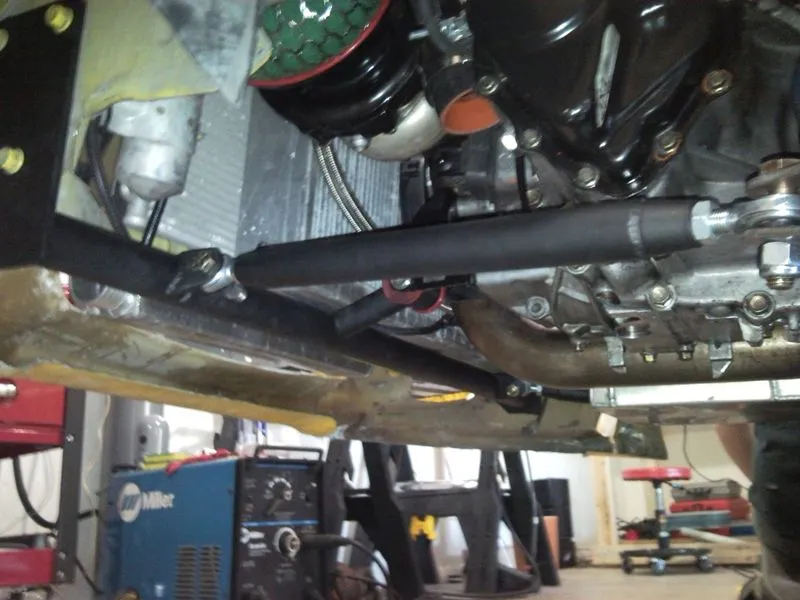

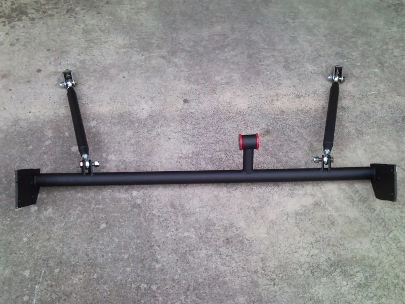

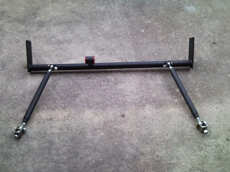

Well, looked like this thread died. So got a friend of mine to build a honda style traction bar for my P5. Haven't run the car with them yet, but it's definitely very sturdy. Replaces but maintains the front engine mount.
did justin make these?!
Well here's a pic of it installed. Tomorrow we find how affects handling

well, a lot seems to have been removed? like the radiator support?
i do love the idea though, ive seen a lot of high hp fwd cars using similar setups with great results, just worried as far as stuff no longer being supported

Radiator support is still there you just can't see it 'cause the traction bar is blocking the view. Only thing that was removed was the Engine C member that the front engine mount sits on. The front engine mount was added onto the traction bar so that engine support is still there.
awesome, and u used the tow bolts as a mounting place? the setup looks very clean, how does it drive?

more pictures looking at different angles would be nice. its nice to see how the fitment is everywhere.
from the pictures that you posted, it looks like a real quality piece.

Its seems that you have every piece of plastic under tray removed. Was that your choice, or can you not keep all of the under tray installed with the traction bars?
