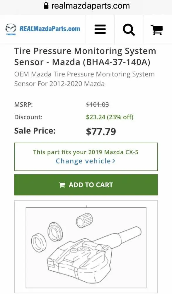

BHA4-37-140A is the part number for OEM TPMS tire sensor on gen-2 CX-5. Not sure if BDGF-37-140 can be compatible to the CX-5. You can try to call several Mazda dealers and verify the correct TPMS sensor part number for your 2021.5 CX-5 GT.

I personally would just use aftermarket Autel MX-Sensor TPMS programmable sensor mentioned in above link for much cheaper price. Just make sure the seller has programmed the sensor for your 2021.5 CX-5 before the shipment. Not sure if Costco can provide such aftermarket TPMS sensor during your tire installation. But that’d be an easier way to prepare your winter tires which require TPMS sensor.

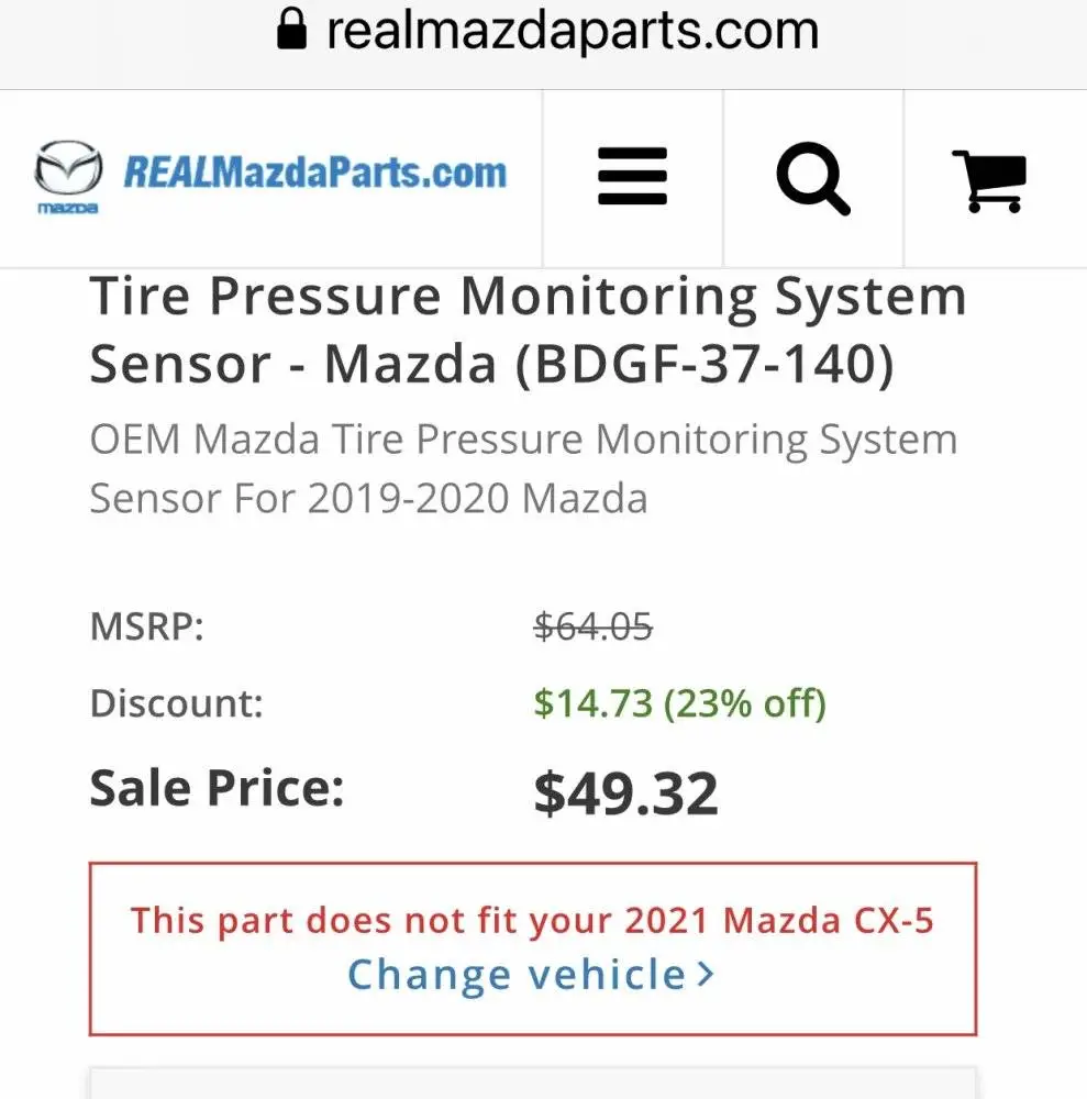

Thank you for your suggestion. I was researching the same website you provided last night; it was a little confusing because part# BHA4-37-140A is for model year 2020 and before while BDGF-37-140 will not fit.

Although the Mazda online website says BDGF-37-140 is for newer 2020 Mazda, but the detail doesn’t include CX-5 but other models.
Checking the compatibility on OEM parts for your new 2021.5 CX-5 is difficult from online Mazda dealer website as the information most likely hasn’t been updated. The parts department at Mazda dealers has Mazda own system, and they have all the latest info and can verify any part numbers for brand new Mazda vehicles. Be prepared to provide the ViN to the parts guy so that they can locate correct part number for the TPMS sensor.

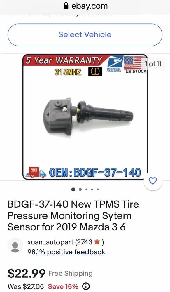

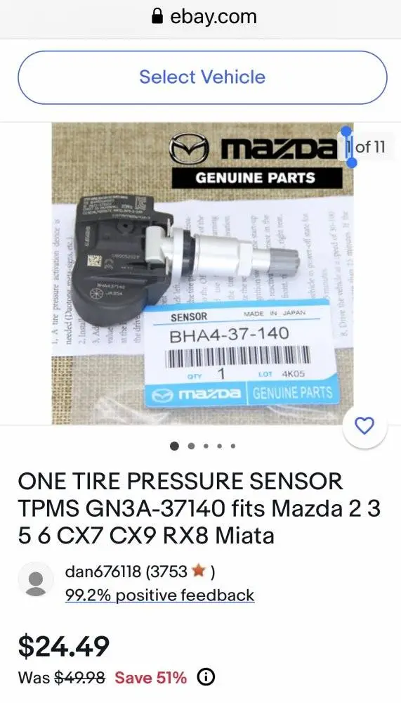

Based on pictures from eBay, looks like the difference between BHA4-37-140A and BDGF-37-140 is the valve stem material; the former is made of metal, the latter is made of rubber. You can tell by looking at the valve stem on your new CX-5 and figure it out what do you have from factory.

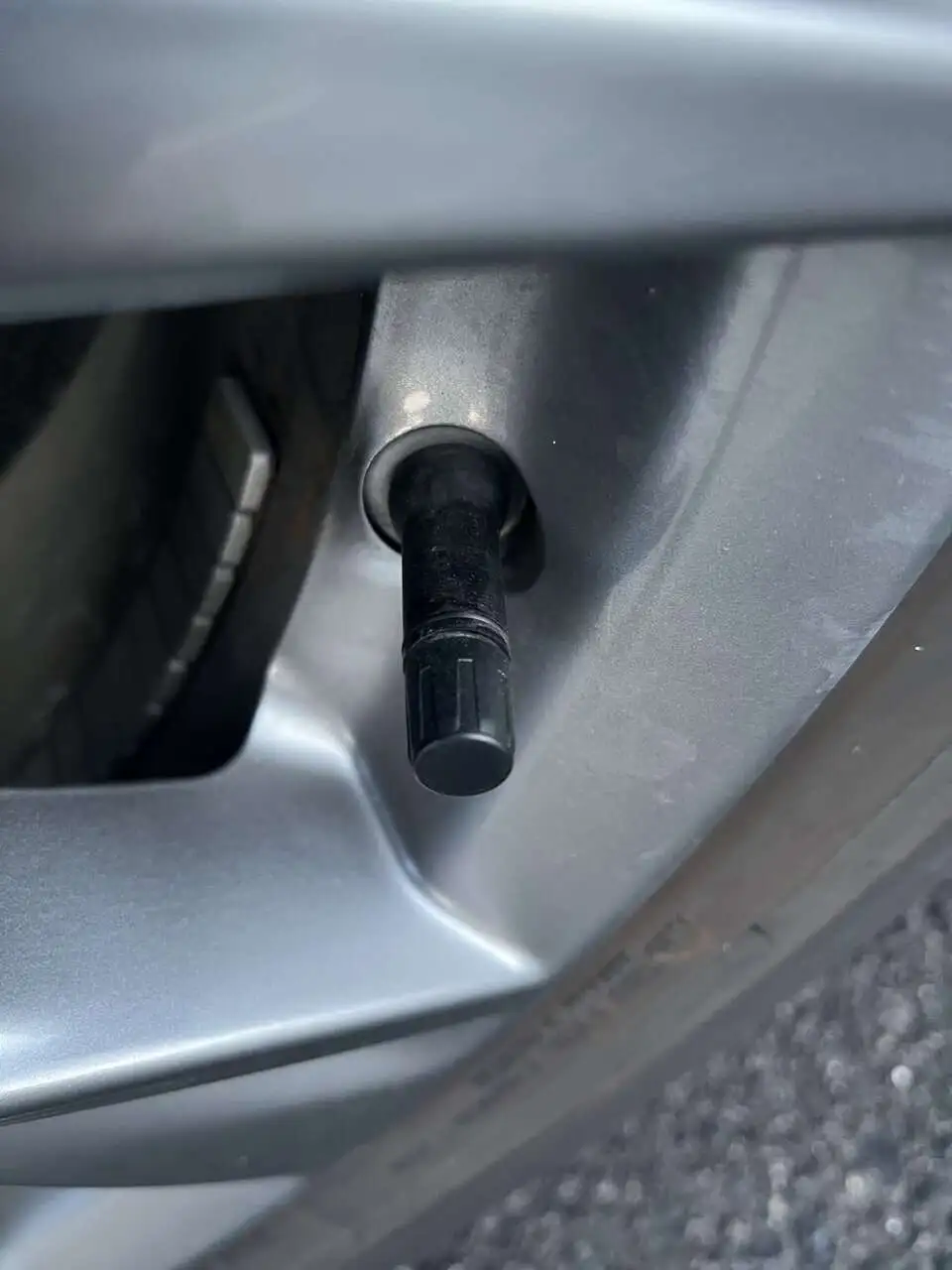

If your valve stem doesn’t looks like this metal valve stem (BHA4-37-140), you should have BDGF-37-140 with rubber valve stem from factory.

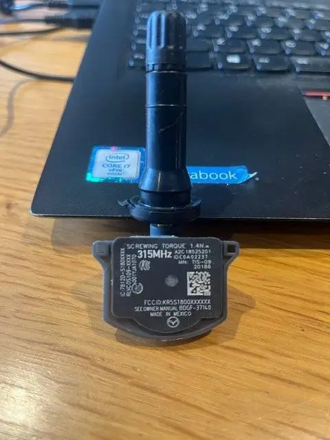

Just FYI, the sensor I have on hand, it has the marking 'BDGF-37140 Made In Mexico'

(BHA4-37-140) Metal
(BDGF-37-140) rubber
Both work. I had a 2017 and now a 2021 where my winters had the metal stems and are working perfectly fine.
I believe the changeover happened for 2021 Model year.
As you are in Canada with snow, I'd say the rubber stems are better as the mounting nuts with the metal tend to fuse after a few years with all the salt.

Good point! factory valve stems are rubber.

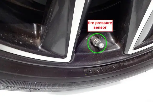

Pic attached, hope it helps.
