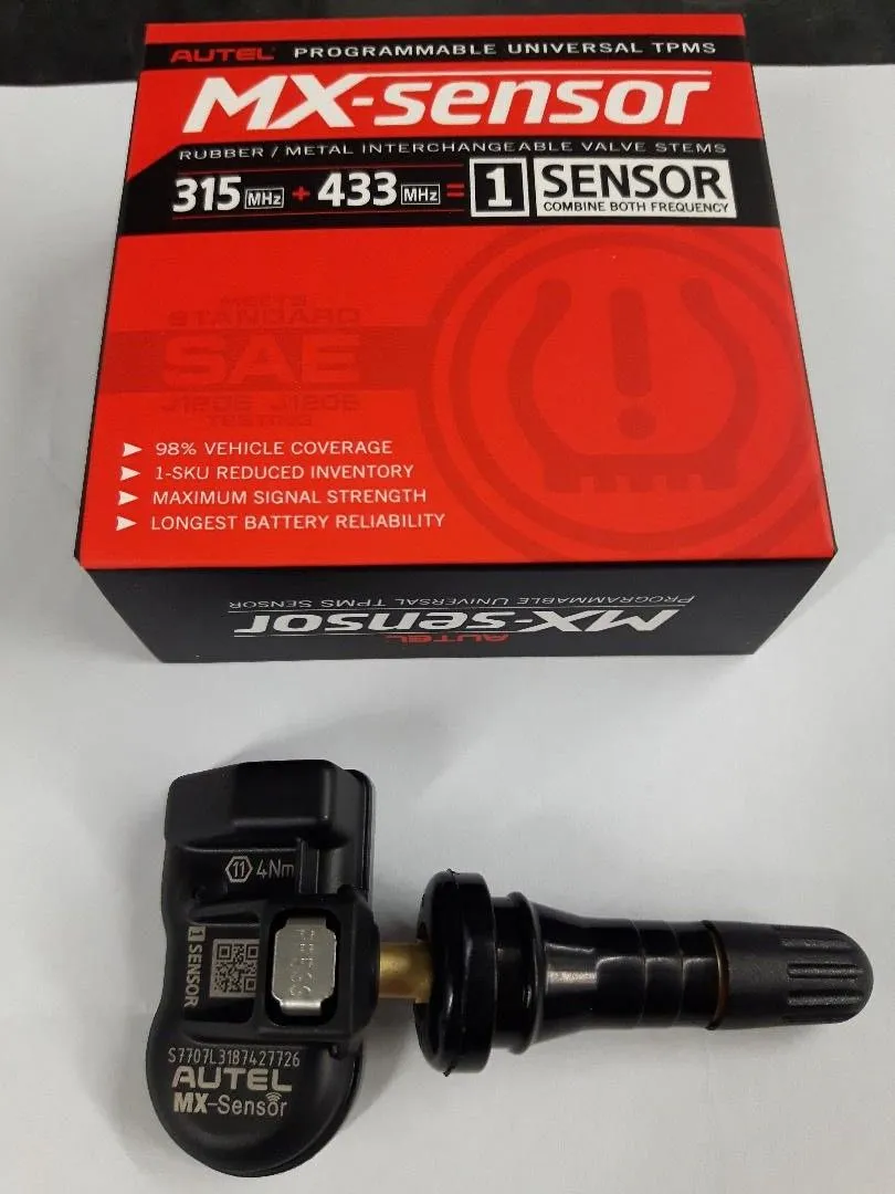

I don't see where you live but on the east coast of Canada where I live they pound the salt to the roads all winter. My Mazda dealer now carries aftermarket TPMS sensors with rubber stems to avoid possible corrosion, as they have had a few reports that the OEM Mazda TPMS sensors with metal stems have shown some corrosion. Here is a picture of the TPMS sensors they sold me that they installed on my separate winter rims.
I don't see where you live but on the east coast of Canada where I live they pound the salt to the roads all winter. My Mazda dealer now carries aftermarket TPMS sensors with plastic stems to avoid possible corrosion, as they have had a few reports that the OEM Mazda TPMS sensors with metal stems have showed some corrosion. Here is a picture of the TPMS sensors they sold me that they installed on my separate winter rims.
attachment.php
Yeah this Autel MX-Sensor 2 in 1 (315MHz + 433MHz) Clamp-in 100% Cloneable TPMS Programmable Sensors Tire Pressure Monitoring System (Rubber Valves) certainly is a good and much cheaper alternative for OEM sensors. $27.19 each on Amazon is a good price. Rubber valve is rust resistant which is good for wintery road conditions.
