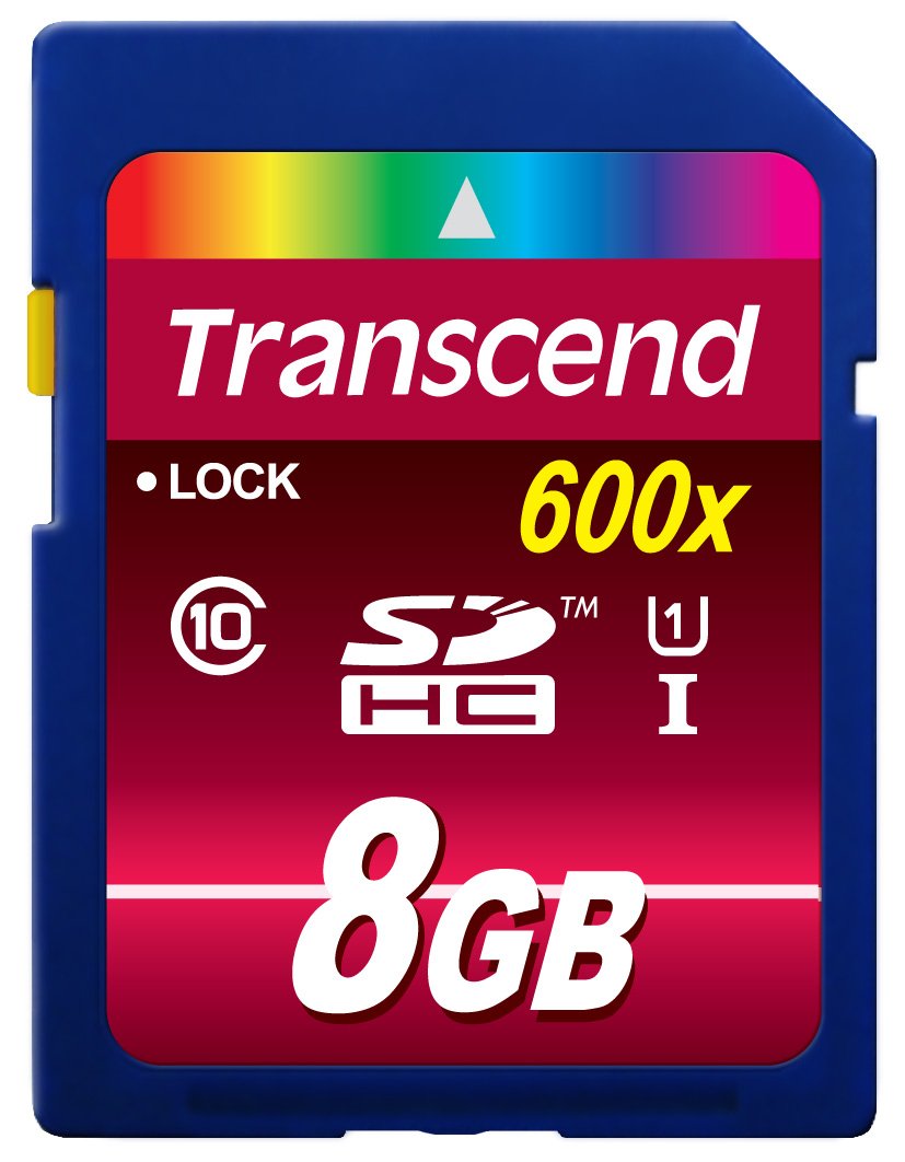

Anyone know any restrictions on it? Just regular SDHC Class 4 or can I go higher? Would UHS-1 SD cards work?

This has worked well for me... I use them for backups

Does anyone have a recommendation for an 8Gb card for the Tom Tom NB1 as my 4Gb card supplied with the car a mere 7 months ago is too small to accommodate the latest gargantuan update?
I know that certain cards with this capacity seem to be problematic with the system.
I went to Microcenter and got the cheapest one. Made a backup of the original and copied it to the new one. Works without any flaws...
No need to spend lots of money on some fancy high-speed high-capacity card.

Whenever I updated my original SD card, TT home would create a backup file, so I inserted the replacement SD card in the Mazda and let it get initialized, then put it in my computer and used TT home to restore the backup to the initialized replacement card. Back to the Mazda, and everything's there on the new card!
