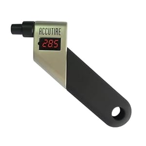

I trusted the airgauge I borrowed from my local Chevron station, where I fill up. When I rechecked, using my digital gauge, I found EVERY tire to be under-inflated at 28.5-30 psi!!
I cranked them up to 36 psi and am enjoying the stiffer ride, though it's noisier. Should improve the sucky MPG's I've been seeing too.
I now use 1 digital and 2 manual gauges on each tire to monitor things. I hope these things are not leaking,...

Mmmmm,.. That bleeder's a nice touch.
I should change the batteries on my Accutire gauge, while I'm at it.
