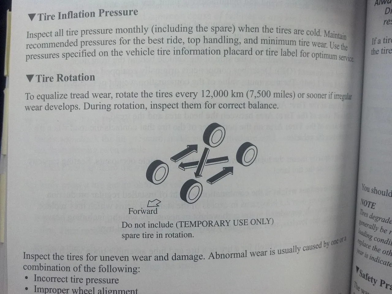

Resurrecting an old post here...
My manual seems to indicate to do a forward cross rotation. I found this on page 9-30 (See attached picture).
My question is that I noticed my dealership does a backwards cross rotation... 1) Is this bad, and 2) in the future, whether I rotate my tires or the dealership does, should I insist on a forward cross rotation?

I seem to remember reading somewhere that rear cross is to be used on RWD vehicles, while forward cross pattern is for FWD.
However, I never saw any justification for that, and I don't really believe that it matters that much.
Thanks for the responses. @arcxer ... I believe you are correct re: RWD vs FWD.
In any event, hopefully this will provide clarification on the original post. Forgot to mention... I also remember calling Yokohama a few months ago and they confirmed the forward cross rotation.
My assumption is that it really wouldn't matter either. Maybe since they've been doing rear cross, I'll keep doing it that way. Consistency is probably my best option right now.
