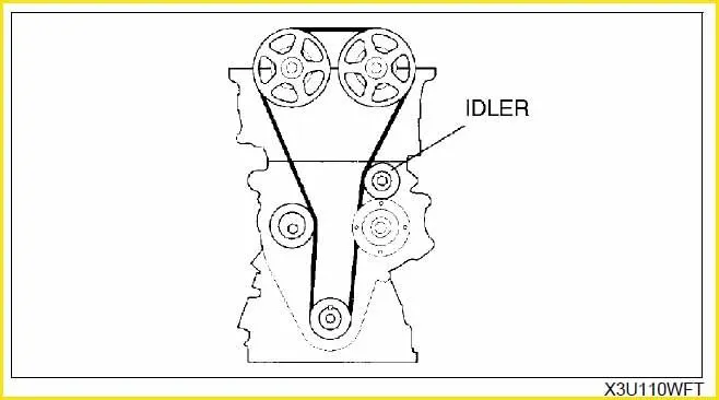

Update: The noise is coming from behind the Timing belt Cover. If I move the cover via a screw driver Flexing the cover, the noise changes....
Q: How hard is it to remove the Timing cover?
Q: Can it be removed without the Valve cover being taken off?
Q: Can I take off the two belts...controlling the Alternator and Power Steering and start the car and see the noise is present. (could be a tenision issue)
I thinking that one of these items in the pic might be going bad. just want to inspect them thats all.

yeah you can take the 2 belts off if your talking about your alternator and waterpump belt... for the other questions... IDK I havent torn down the motor that far, but Idk why you would have to take the Valve Cover off to take the Timing Belt Cover off...
I dont know why you would have to take the valve cover off either. Just wasnt sure, I was hoping someone could tell me what I need to take off to save time but I guess I will do it the old fashion way and just trail and error.... thanks for the quick response...
wll your going to have to take your alternator belt and your accesory belt off, I am pretty sure... but I dont think you should have to take any thing else off... I'm pretty sure the alternator and stuff are out of the way enough... but I would suggest lifting the front end of the car when you try taking the bottom bolts off of the Timming Belt Cover... just to save you some hard times when you get there...

Since you broke down our motor, was it hard to remove the timing cover? I bet you removed the valve cover first so it didnt matter to you?? Anyhow I'm still hoping that its something small....(key word..HOPING) Thanks for all the input from you guys.
PS..... Its taking me so long to figure this out because I've been out of town and in the Hospital for surgery...so once all is well, more attention will be put toward this....
hey man, you dont need to take your valve cover off to get the timing cover off... but you will need ot take the passenger motor mount off... and quite honestly it is going to be difficult... theres just no space on that side of the motor... but howd your surgery go? hope everything is well.
Surgery was fine, I just can do anything that requires me to do physcal strain till after I see that dr. next week!! It sucks being home for a week and cant do anything that needs to be done... oh wel gotta get well first.... IF I was to remove the passenger fender wheel lining would help me see more or get more access?
