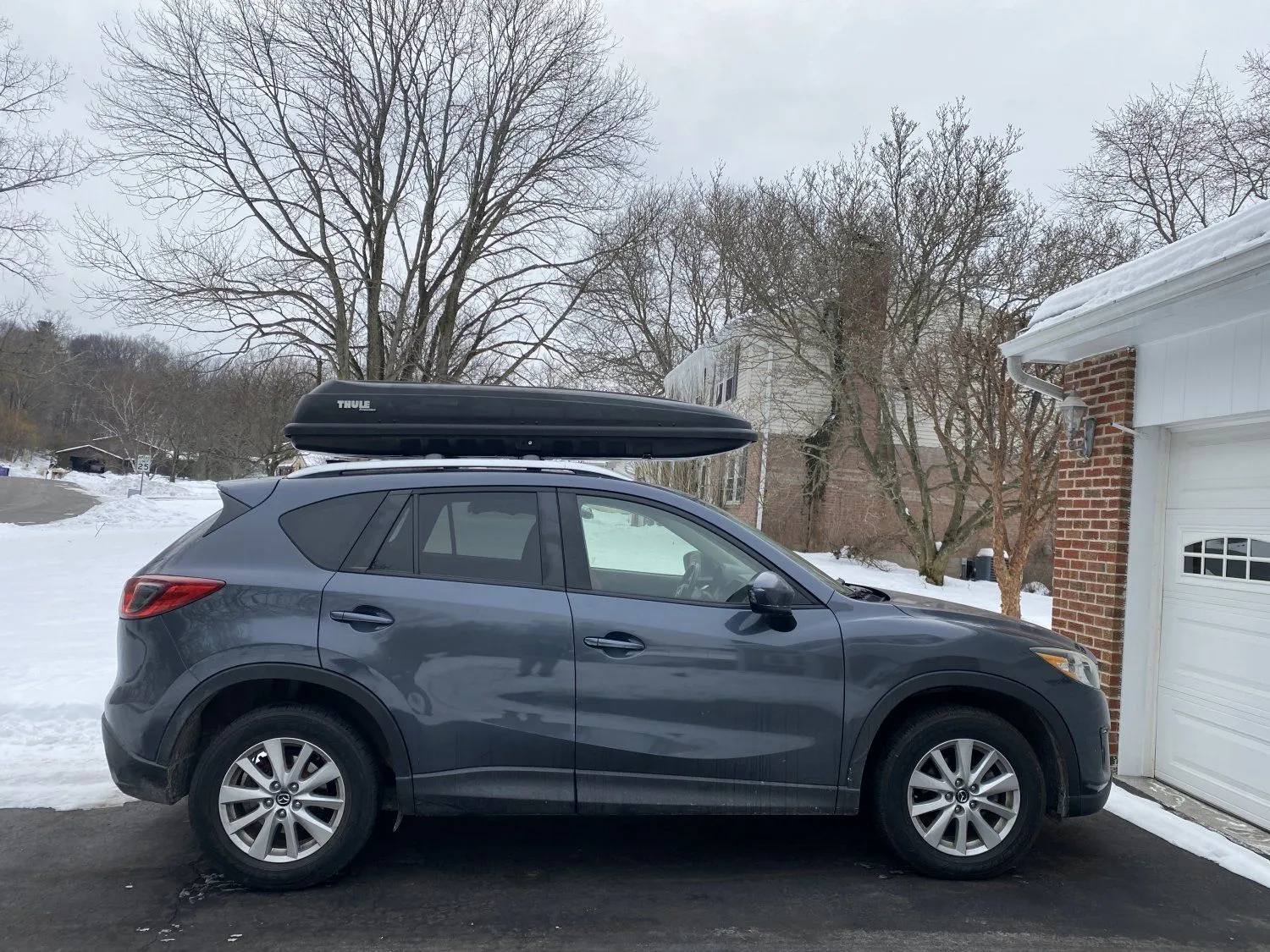

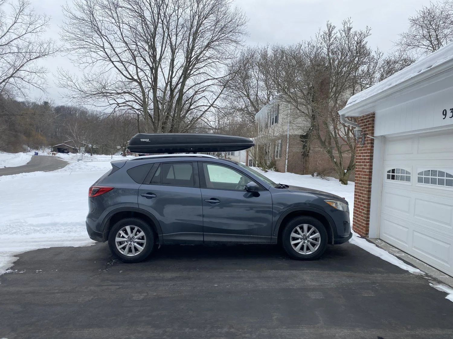

Hey guys, just installed a box on my 2013 CX-5 and figured I’d share my experience here.
It is really a pain to get anything fitted on Mazda OEM bars with I was able to get a Thule Frontier 668ES on my CX-5. I’m able to open the back hatch all the way as well. I did however have to drill some holes in the middle but everything seems to be solid and stable on the highways.
I do of course check every once in a while to see things are ok. The placement of the box however is pretty far forward. I do often get vibrations once I hit the speed 70mph+ but seems to be safe so far.
This box is of course an older model and I’m curious if any of the newer ones would be more compatible with the CX-5s. I do see on the Thule website about how newer boxes are more forgiving regarding the hatch opening and the back end of the boxes.
The roof isn't long enough for a lot of boxes.
Some have the rear with the slope that allows the hatchback wing to clear, but don't mount a box that could damage the shark fin, it will distort the sheet metal.
