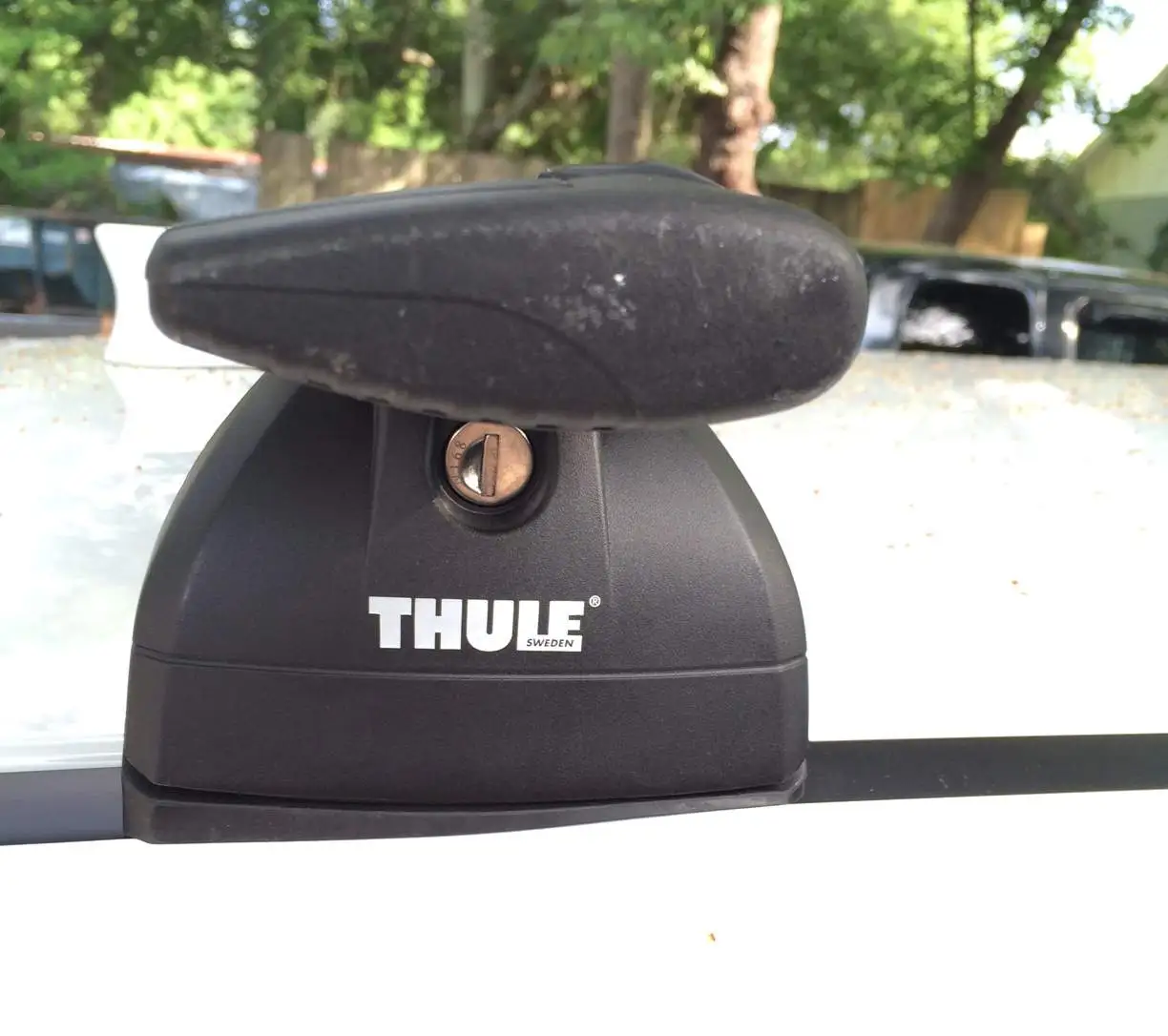

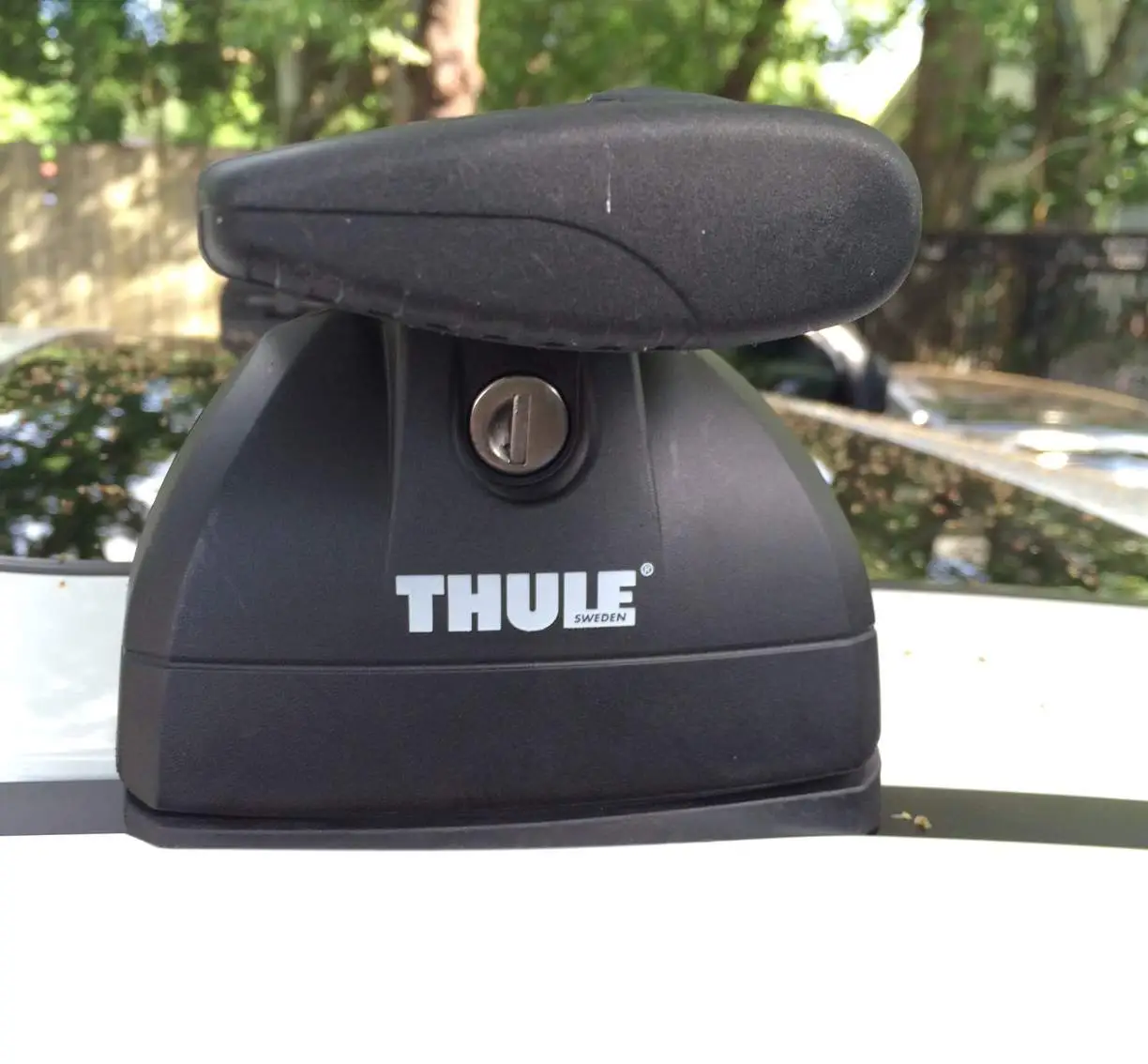

Here's a close up of how the 3069 with the 460R feet look and you can see, they fit very well.
This is the front 460R foot with the 3069 Fit Kit
attachment.php
This is the rear with the 460R foot and the 3069 Fit Kit
attachment.php

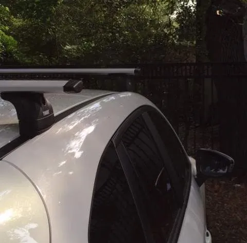

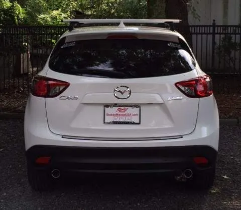

I'm still waiting on my ARB53, but I did have some ARB47s from my Mazda 3. Some people may like the less wide look more, but I'm short and need that extra 6 inches of overhang racks so I can get my boards on the car easily.
47" wide AeroBlades back view
attachment.php
47" wide AeroBlades off angle view

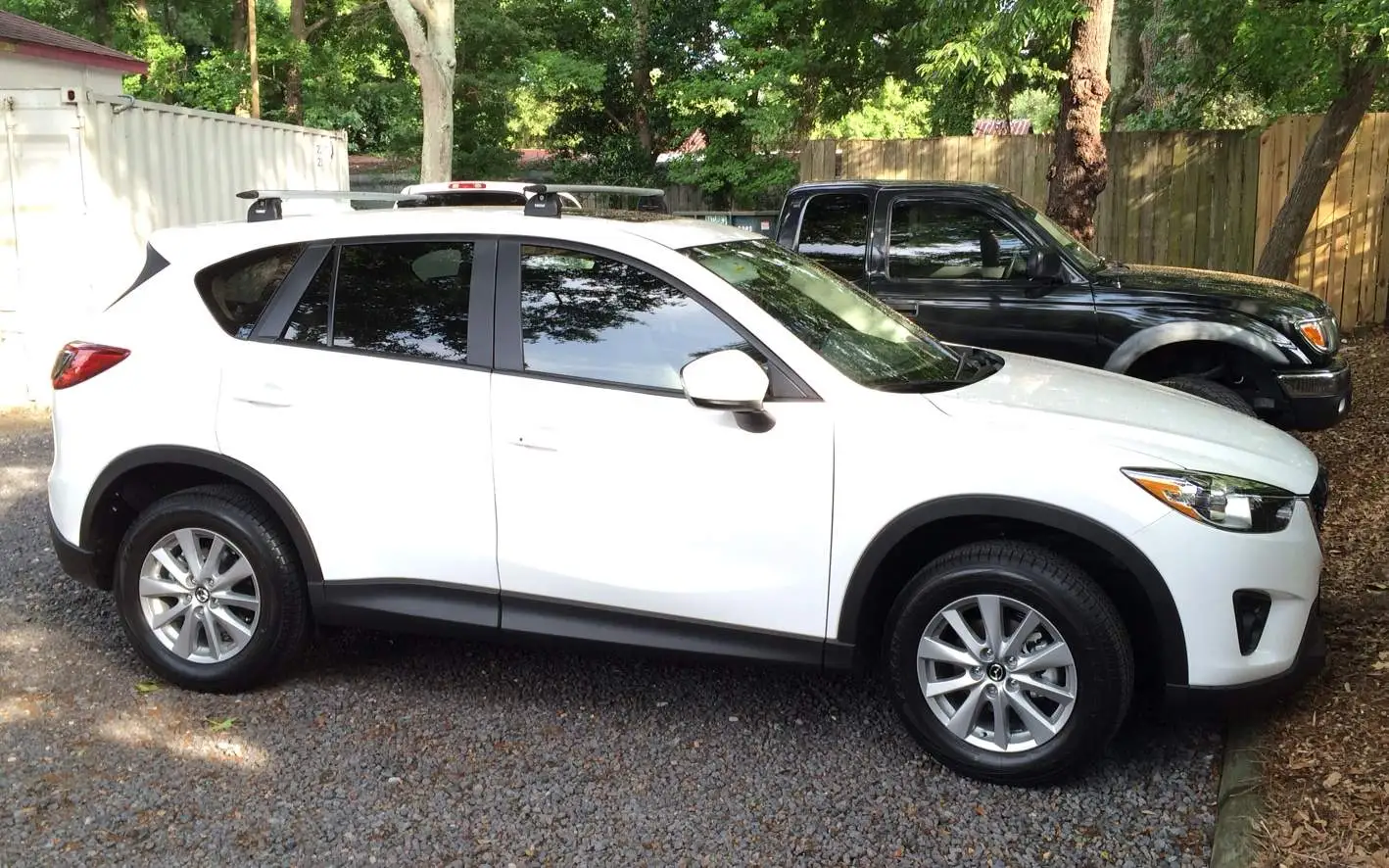

Two things: what's the wind noise/MPG hit like with those bars? And, do you have a wider picture of the car with the bars installed, to get an idea of the all over look/relationship of the bars?

Noise isn't bad at all, but I have the radio on all the time and rarely drive over 60mph. They seem to be the loudest at about 45 and then get quieter around 50. You will hear them, but the AeroBlade is so much quieter than the square Thule load bars or the Yak rounds.
Here's a side view, is this the view you're talking about?
attachment.php

Perfect! Thanks for the info and pictures. This is exactly what I was looking for. Drilling through the gutter guard is no problem at all. I've the the exact same CX-5 as you, so it's awesome to see how the setup will look. Thanks a ton for the info.
