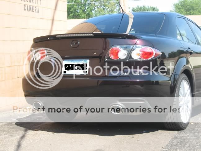

For the sake of argument..I have Magnaflows on my Acura and have never had a melting or black discoloration issue. Take a looksie.

That is a regular bumper.... heat treated paint, probably a strong polyeurathane...
This on the other hand, is not...

But back on topic if you properly install the Magnaflow kit there will be no melting and no blackness. I agree that the stock stuff looks like poop when you find out that it is all for show and not the actual tip.

I was not saying that there will be no blackness at all just not as much. With the stock exhaust the tip is set back (without looking 3 in. into the bumper) and then the foe tip is set out flush with the bumper cover. This in turn makes something of a jump that the unburned gas must make and it lands on the foe tip. That is way there are so much of the carbon/unburned gas stains on it. The magnaflow kit will take that away and let that spray just fly out and not catch it.
The reason the bumper was melting is because the tip was not in the canter of the hole in the bumper. Just because the kit says bolt on doesnt mean it will fit perfectly. You may need to make some adjustments to it.
