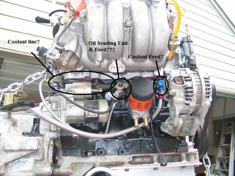

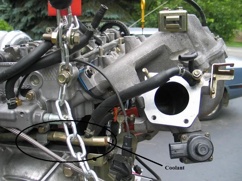

I found this pic on one of the build threads I have saved. I was curious what line it is that I have circled. Is that the oil line or a coolant line? Seems like it goes to the oil sending unit, but for some reason when I recall working on my protege it is in the coolant location....Where the sending unit is, is also where the oil feed goes to as well correct? I think I confused myself on the locations...
it is a coolant line...if you look closely it isn't attached to the oil pressure sender...it's supposed to go to the oil cooler
but the oil cooler is different and as far as I can see in those pics he just capped that line off nearby the oil pressure sender
he has two lines on the oil pressure sender
one is the electrical for the sender and the other (the braided steel line) is the oil feed line, yes
