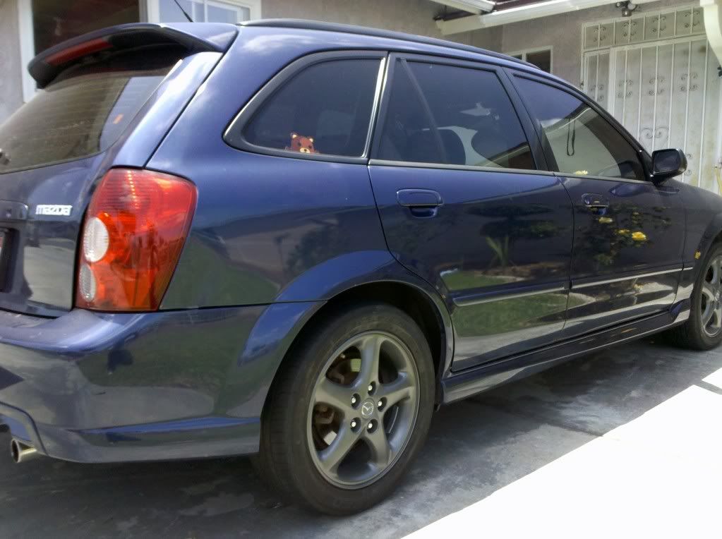

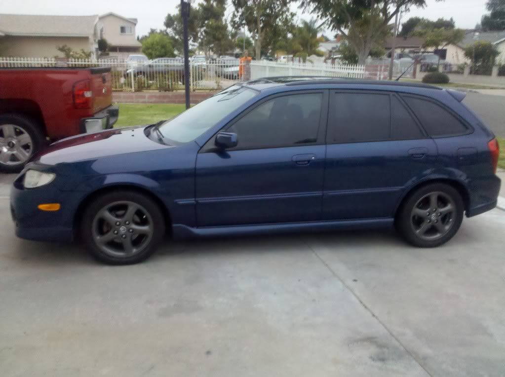

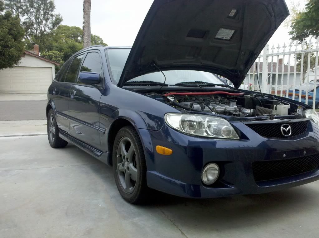

i painted my stockers a few months ago and used graphite too! i have NO chipping and they still look great (didnt take off the tires either)
took me 2 days (i took a lot of breaks)
what i did:
1. pry off wheel weights
2. clean them with a scotch pad and 'simply green'
3. rub down with alcohol
4. sand with 800 sandpaper
5. repeat step 1
6. sand with 1200 sand paper
7. repeat step 1 and 2
8. tape off tire
9. 3 coats of gray primer with 10-15 min. drying time between coats
10. 1 hour dry time before color coat
11. 3 coats of color with 10-15 min. drying time between coats
12. 1 hour of dry time before clear
13. 5 coats of clear with 10-15 min. drying time between coats
14. let cure as long as possible before mounting them
15. take them to get balanced using sticky weights so it wont show as much
16. mount and enjoy beauty
its not hard at all, if you have a few friends that can help with sanding then its really a breeze.
