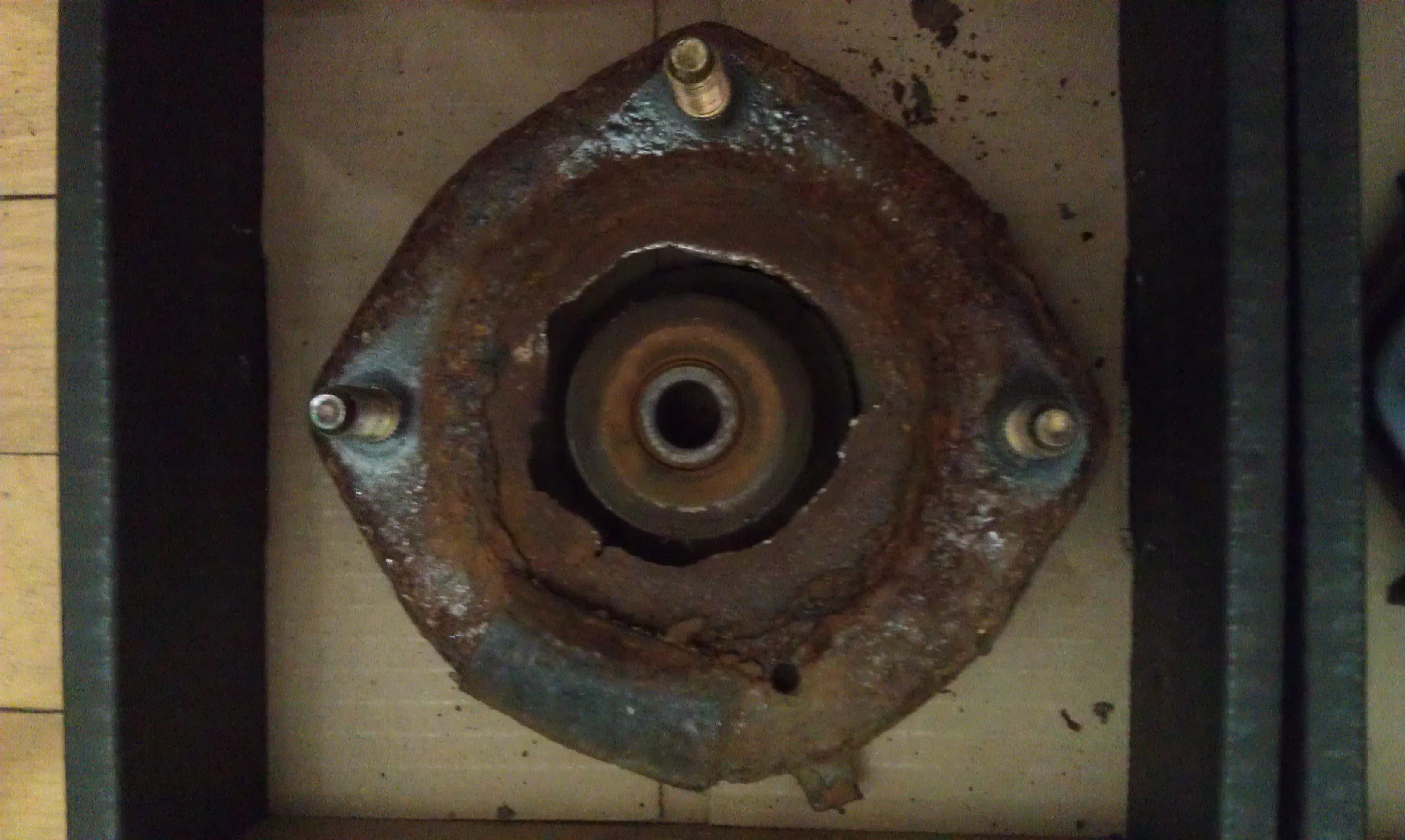

The clunking from the right rear suspension area of my '01 Pro ES started at about 120k, and the problem revealed itself loudly at 199k...
Top:

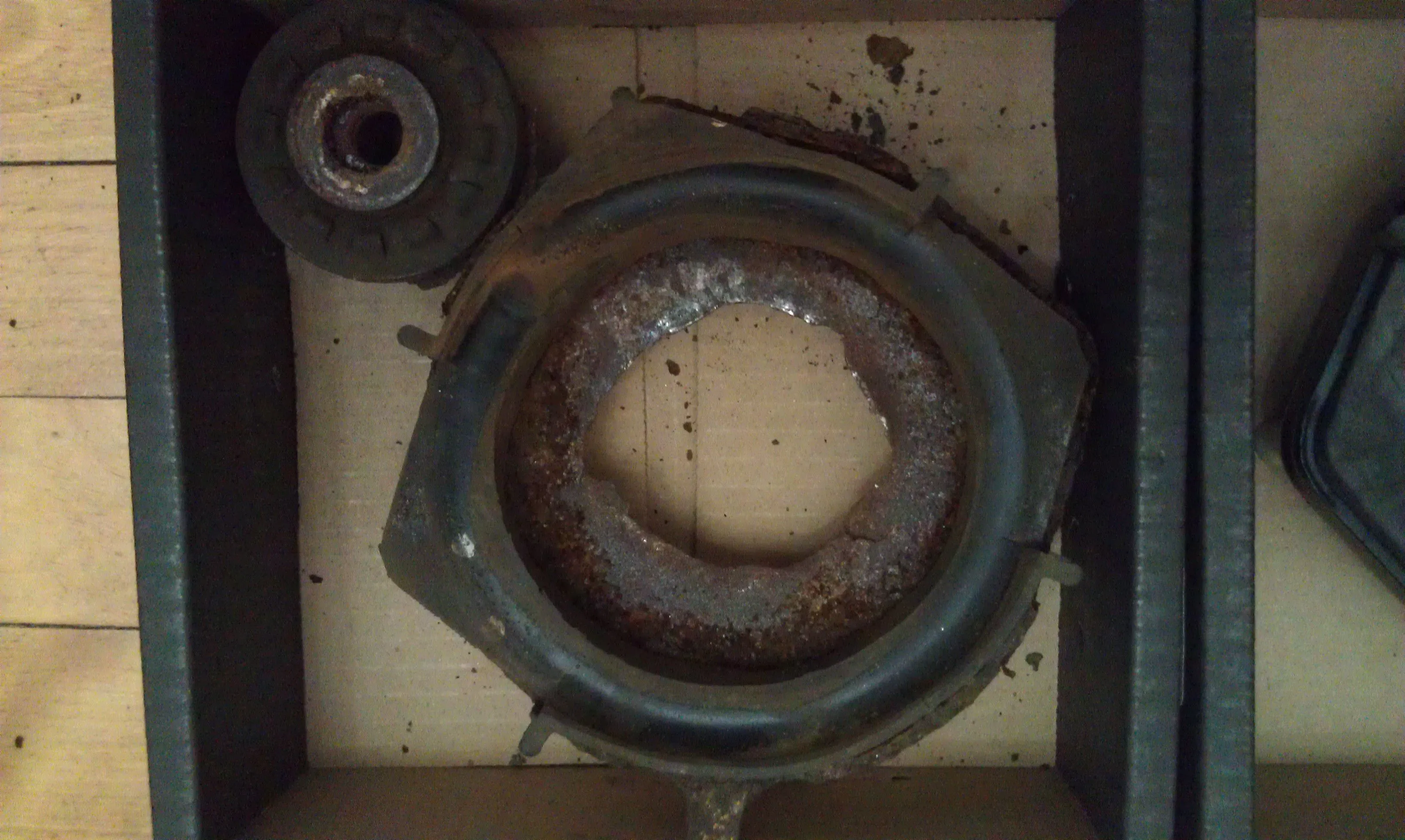

Bottom:
I'm replacing both rear upper strut mounts with KYB mounts. Still the Rustoge is slowly turning into dust...
That will do it, the one on my 323 was like that but rusted to the tower and strut. One piece came out rusted to the strut one piece beat out with a hammer and chisel and the rest grounded out
