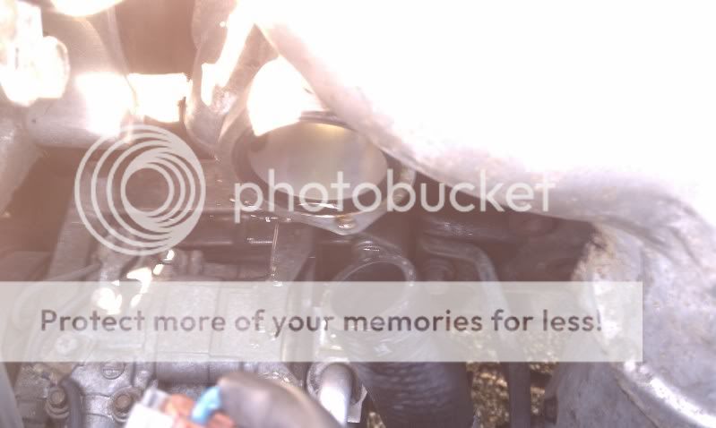

PLEASE HELP ASAP IF SOMEONE CAN CALL ME AND HELP WITH CHANGING THE THEREMOSTAT ASAP 714-742-2367. I removed the housing attached to the lower radiator hose and there is no tthermostat in there. See picture please help asap!

The check engine light was most likely for incorrect coolant flow. The guy who sold it to you probably had an overheat problem that could not be figured out or was too much to fix. So by removing the thermostat, it made the car run at a fairly normal temp by creating more coolant flow to the radiator. So do not be surprised if the car overheats with the new thermostat in place.

If its a fail safe t-stat it would stick open and in your case no t-stat yeilds the same results. The car never reaches operating temps withing a certain duration of time and trips a CEL and from the looks of your pictures. It appears that he only had straight tap water in the block. Now thats saying its a warm day outside... if its cold the car will never reach operating temps.
