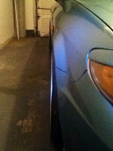

this is 18x8.5 +30 on 215 40's - gtpro coilovers, rear camber plates, and aac link kit
Most impressive. Definately is a must. I'm gonna run just the Coilovers for now and drop on my mazda6 wheels till I decide what wheels I'm gonna go for. Once I've decided ill get those links and the camber plates. Thanks for the info!!
