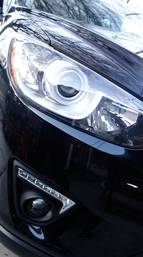

I will say that these are absolutely phenomenal when my lowbeams were completely coated and blocked by snow/ice. They give nearly as much usable light in the snow as my lowbeams and the correct light pattern with cut off. It is not the color (which is true white at 5000Kelvin), but more so the light pattern.
I can confidently say at least 95% of the foglights on the market (be it factory or aftermarket) are no longer REAL foglights. They're just selling points and accessory lights with no usable light coverage on the road. This include both the OEM halogen H11 Mazda foglights and new mini OEM foglights that come with Mazdas as of the past couple years equipped with LED front lights. The closest factory foglights I've seen perform as well as the Morimoto XB's are the factory LED foglights on the Land Rover Range Rover.

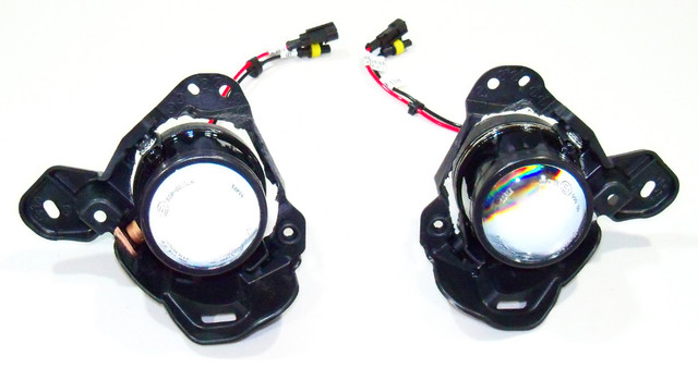

this below..... but it is far from plug and play, see Mazda3 link below, I got them cheap during their sale and it will fit the OEM brackets at the required 3 mounting points but need to shave a lot of plastic off in the bracket rear to make it fit, I haven't gotten a chance to install them yet, looks like a universal HID projector housing and they provide a molded bracket to fit into existing OEM bracket but the OEM bracket opening in the back needs to be Dremel'd out, I got two spare OEM fog brackets from RockAuto about $6 each so I can mount them, I'll post pictures and video after I get them installed.

the JDM sale was back in February, they were like 1/2 the price of the Morimoto's LED (I recall the HID projector housings for a pair was $90 shipped, they don;t come with HID kit, you have to buy that separately), like I said, it's not plug and play, the projector housings are too long and don't fit the OEM brackets, I have to Dremel a lot of plastic away to make them fit. You can see in the JDM link there are three mounting stubs, two on the sides for the main mounting and one on the bottom to allow swivel adjustment of up and down.

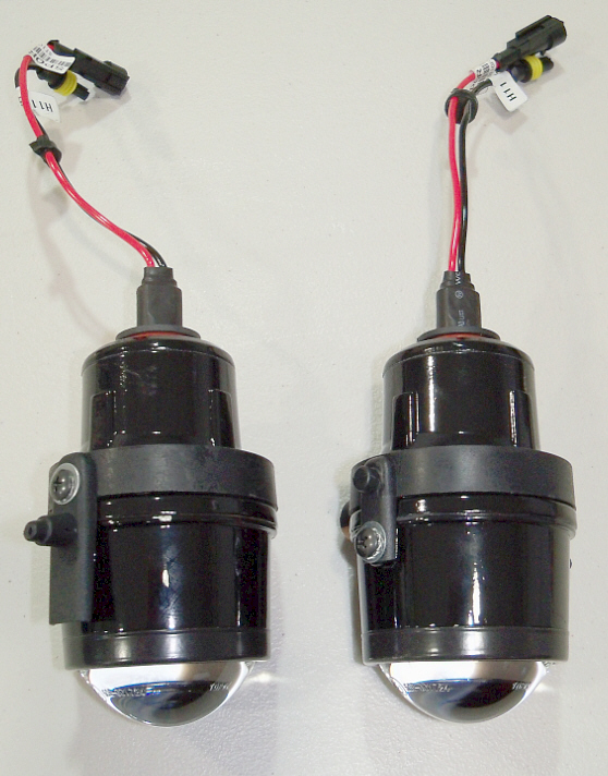

Something like this, I have made myself. I have got a set of projector light kit off of Amazon, for $23 and I have made some spacers & brackets, to make them fit into the original brackets. I did all this, by eyeballing everything(that is why is not sticking out enough and it is not exactly in the center of the opening). Eventually, I will remove them and make the necessary modifications.

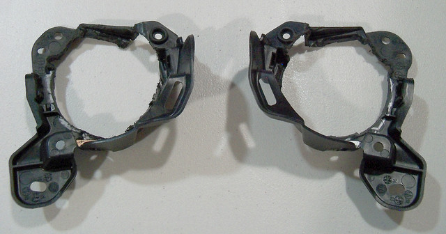

these are the aftermarket HID projector fogs from ijdmtoy, they only provide the plastic sleeve that mounts onto the OEM brackets, they don't privide the whole OEM brackets that need to mount to the car bumper.

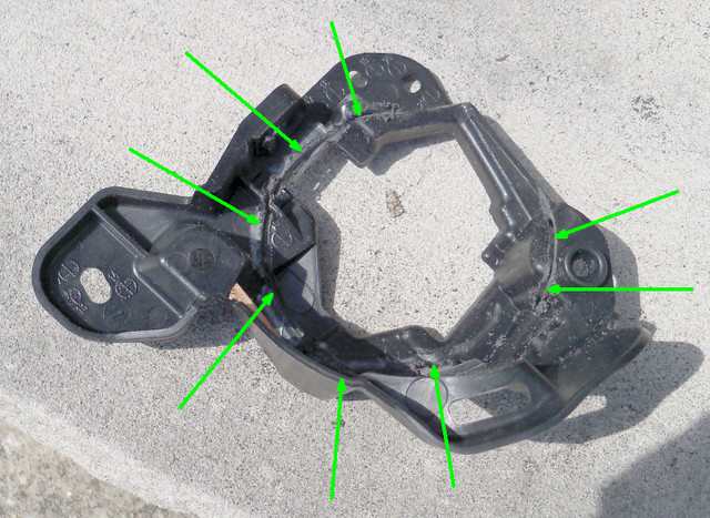

problem is they don't fit the OEM brackets unless you remove a lot of the plastic from the brackets.....

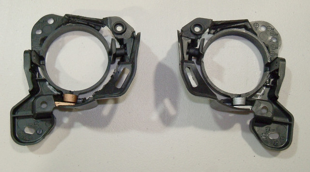

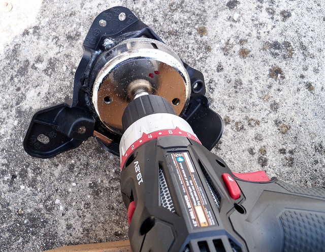

you'll need a 90mm hole diamond drill for $6
https://www.ebay.com (commissions earned)
just use the 90mm bit to get the general circle shape then you'll need to use a dremel to cut out the smaller pieces,
you'll have to constantly to a fit check with the aftermarket sleeve to determine which plastic area to remove....
once you have that done, the aftermarket sleeve should fit in nicely
it can swivel similar to the OEM fog housing........

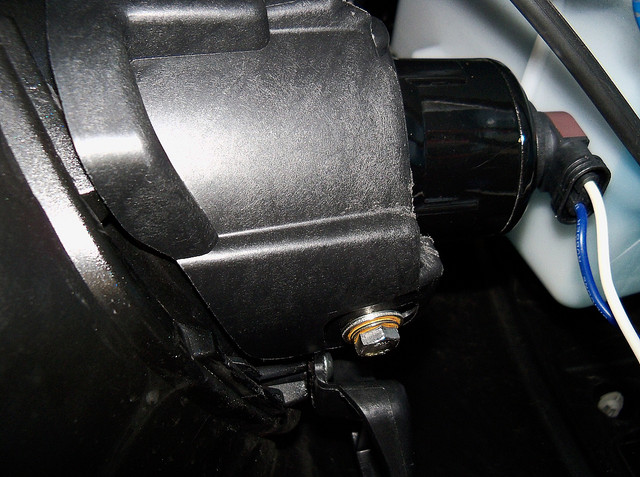

needed to get a right angle type HID bulb, the passenger side with the washer fluid tank is very close

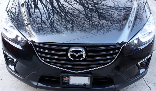

got a chance to put in the HID projectors....
I don't recommend the iJDMtoy.com HID projectors , light output is tolerable but not as bright and spread out as I thought it would be..... video below
I don't recommend the iJDMtoy.com HID projectors, light output is tolerable but not as bright and spread out as I thought it would be.....

I'll try some new bulbs and readjust the aim and see if it improves, but I wasn't impressed with the light output, spread is even less than the stock OEM housings, you can see in the video.....it has distance and a good cutoff but no intensity, the passenger side was a tight fit because of the windshield washer fluid tank, there's just enough room to get the assembly in but no way to swap out the hid bulb without unscrewing and taking out the whole assembly unless you can get an H11 HID bulb with a right angle wire like this....
honestly, I would just save yourself money and go with Morimoto LED's
I have done a similar setup, but I have picked up some similar projectors, for $23 from Amazon.
I have machined some spacers to mount the projector to the factory bracket.
One side it was easy to fit into one of the holes, but the other side is offset. I had to make a little aluminum bracket to bring it to the same level as the other one.
My only problem is, that I was doing all this, without trying them out on the car and they are not sticking enough out, and they are slightly off center, from the plastic trim hole.
