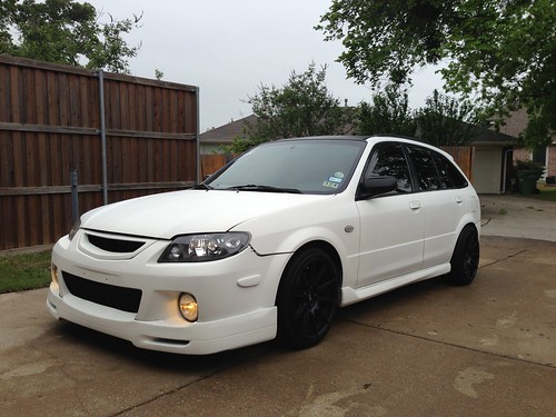

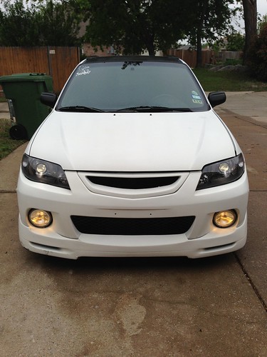

It'll take about 4 gallons to dip a whole car white and get a good finish.
check out dipyourcar website.
about 300 bucks to dip the whole car.
About a can will do all the trims on the rear of the trunk + valence. 2 cans if you wana do multiple layers for a better finished look
Luckily I have 2 cans. So looks like its more then enough. I wasn't able to start plasti dipping today so I'm thinking of doing it first thing tomorrow. Now I'm worried if i were to do it tomorrow, I got work the next day and apparently there's a chance of rain... does anyone know the curing process? Will I be good by Monday? Maybe I should just wait ... hmm
