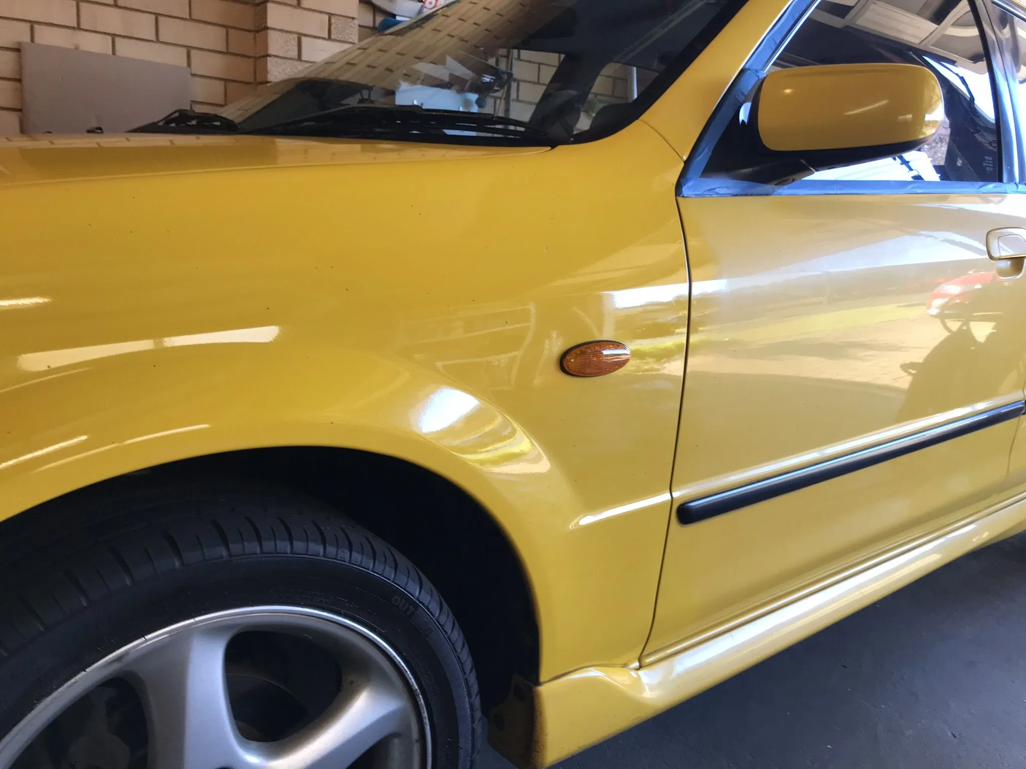

What surprised me was that for its age and 290,000kms, it still pulled all the way to redline with no smoke...yet. I paid A$2200 (~US$1600) for it - cars are more expensive here, and got to work. The front quarter panel polished, and the faded door waiting it*s turn.

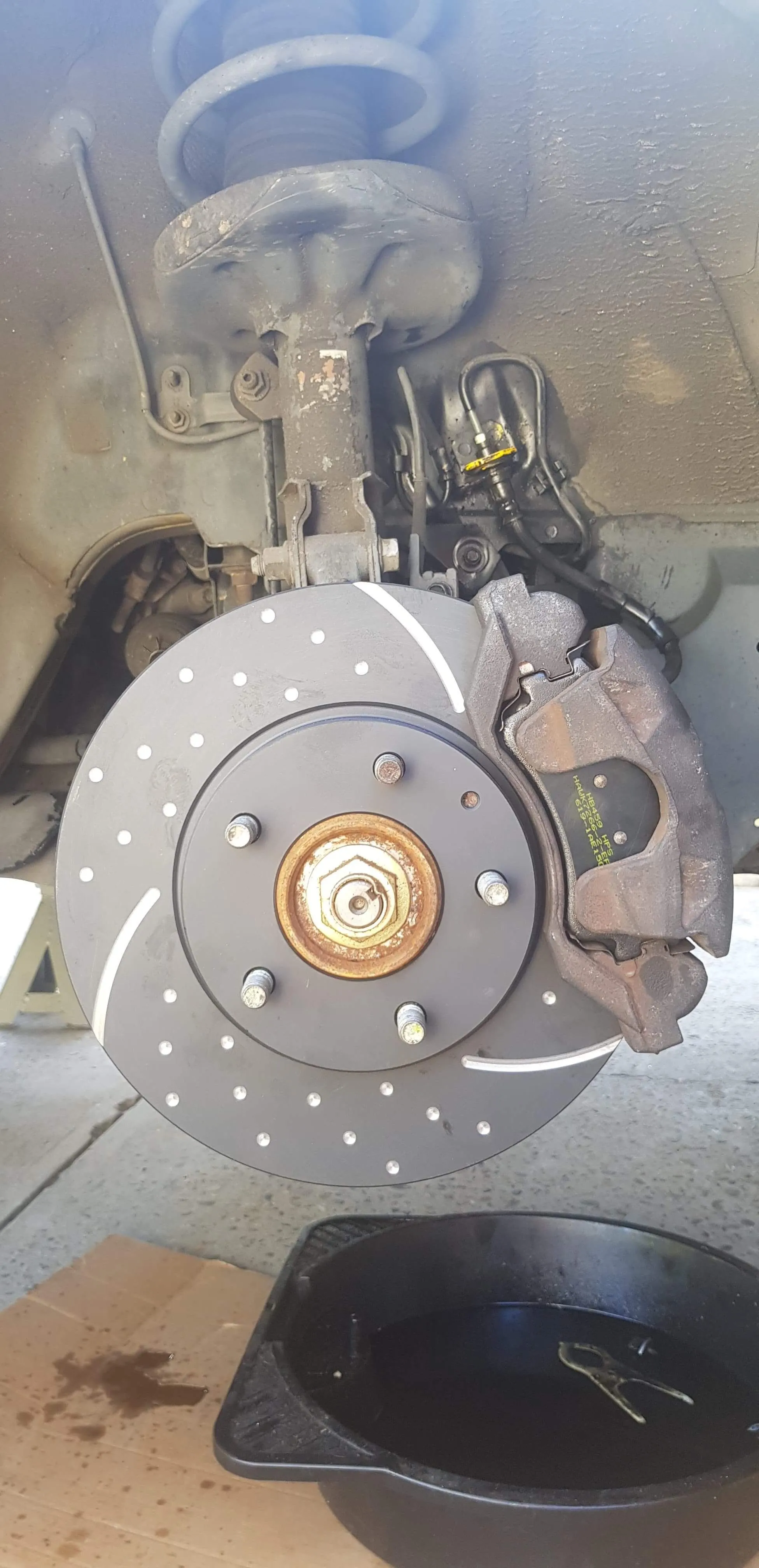

We then got onto the brakes - Mazda6 calipers with new pads and 273mm rotors

Which Mazda6 brakes did you fit? That is on my to do list. Any hints? Is the Mazda6 flex hose being used on your set up?
Welcome! Looks like the car is scrubbing up pretty well
What disks did you use for the swap, they look a whole lot more grippier than the standard ones
Thanks! Still a bit more cleaning to do. I did the oil change on the weekend and man...it*s dirty under there.
Rotors are RDA, and Protex blanks for the rear.

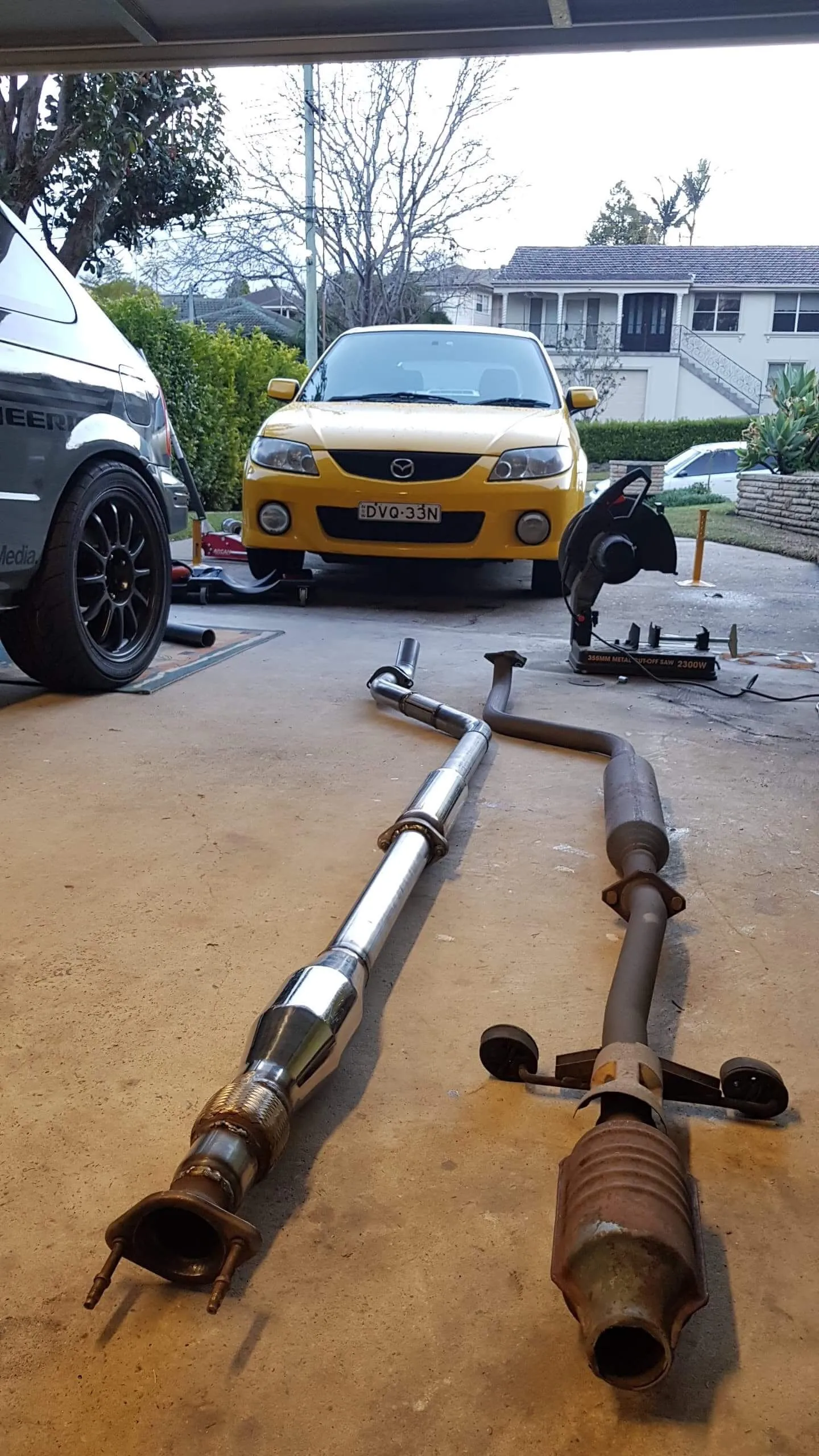

A friend of mine who has been learning to weld is building a new exhaust...I suspect it will be quite loud given the size of the resonator and muffler, compared to the original unit!

LankyKiwi - I*m hoping to gain a few ponies! This is my mates first attempt at building an exhaust and we*ve figured out one of the flanges are in the wrong place already, haha! I*m a bit concerned it will be too loud though, but the stock resonator looks like a 2.5* that*s been reduced, so hopefully that will fit if we need to quieten it a bit.

A little more progress on the exhaust system - rear section now complete. We ran out of 45deg bends so cut a section of a 90deg and angled the cuts a bit. Now to get the hangers on.
Test fitted
I think the cat must have started to blow itself to bits. There*s a whole bunch of little bits of stuff rolling around in the old rear muffler. Just as well this is getting done!
