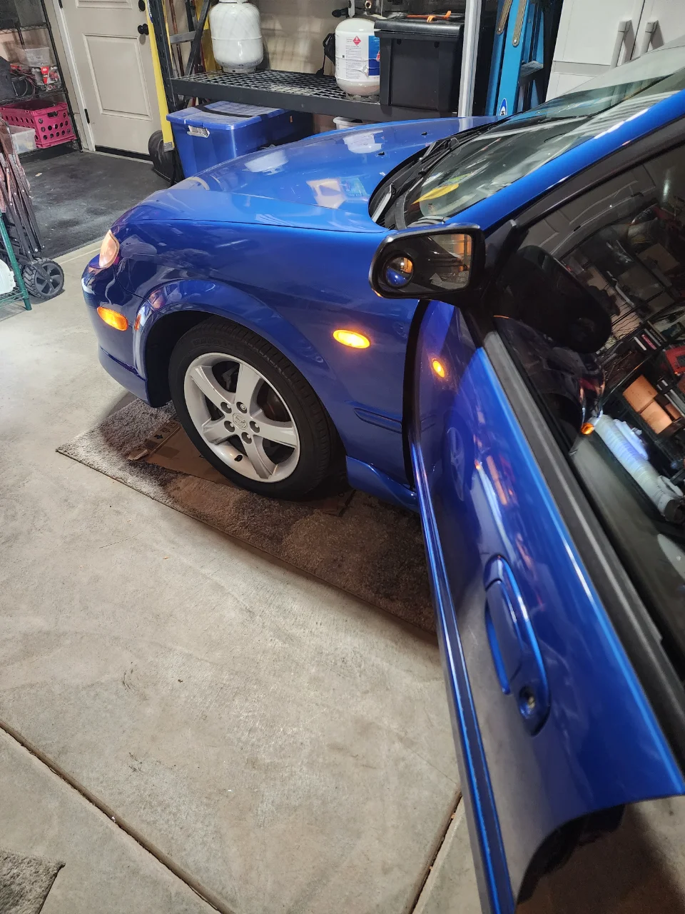

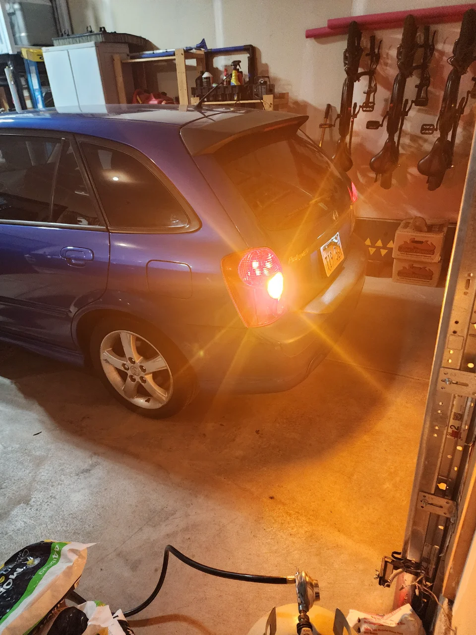

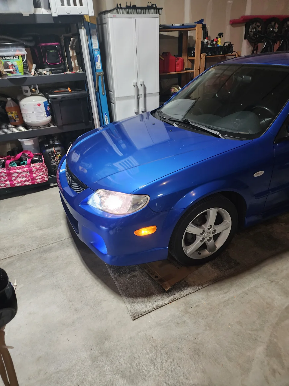

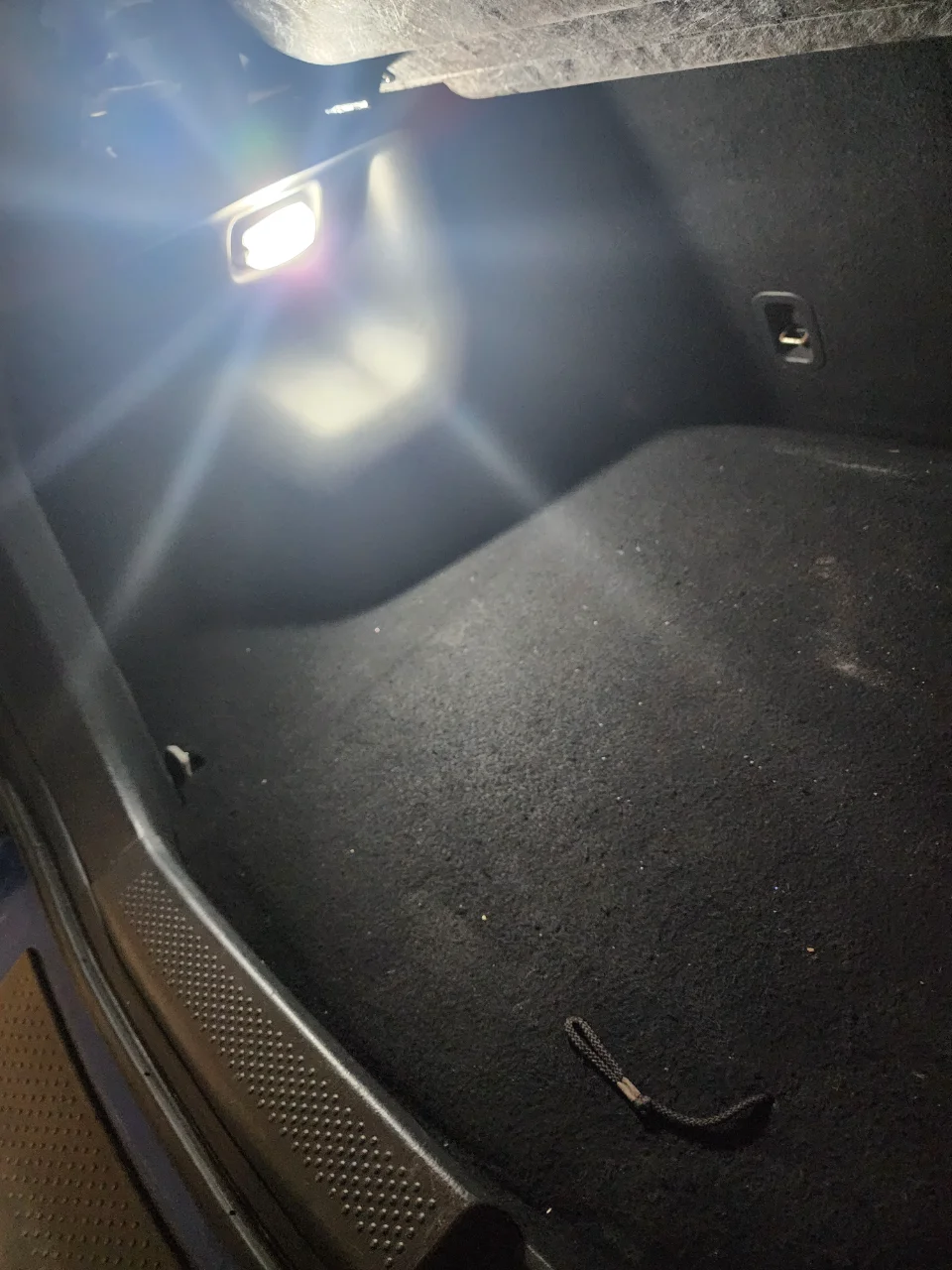

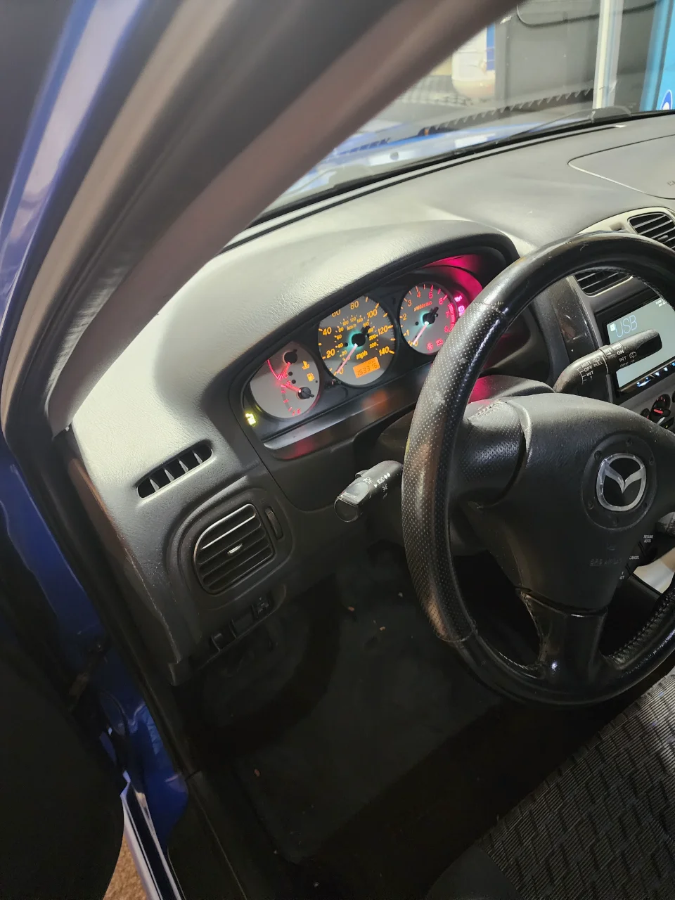

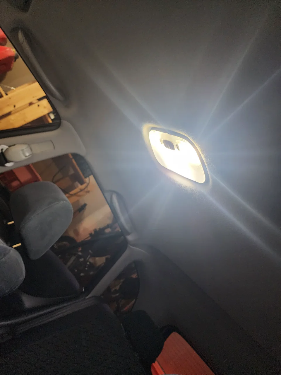

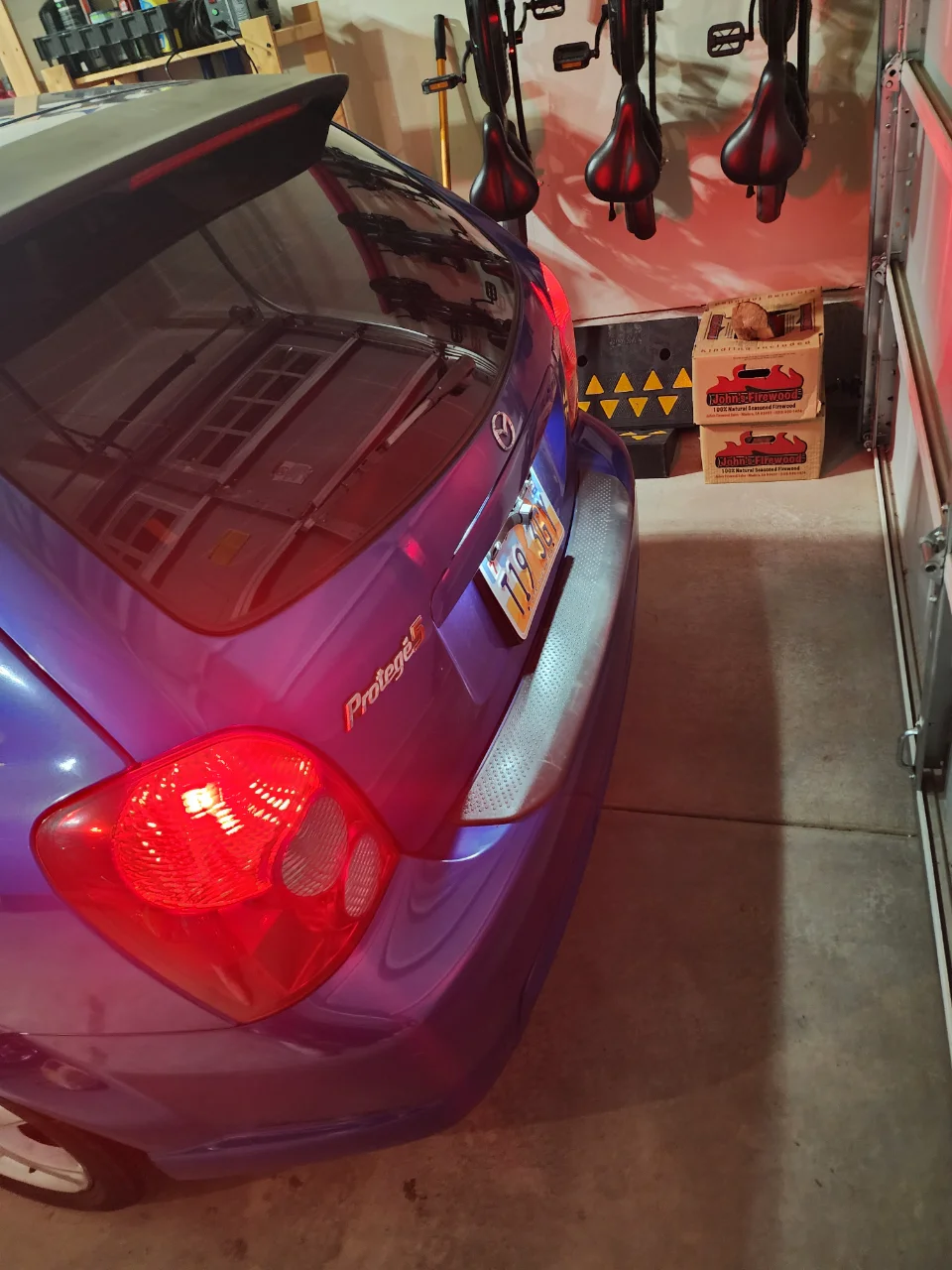

With the exception of my headlight low and high beam bulbs, every single light bulb in my 2003 P5 is now LED, even the instrument cluster. This list definitely helped!
