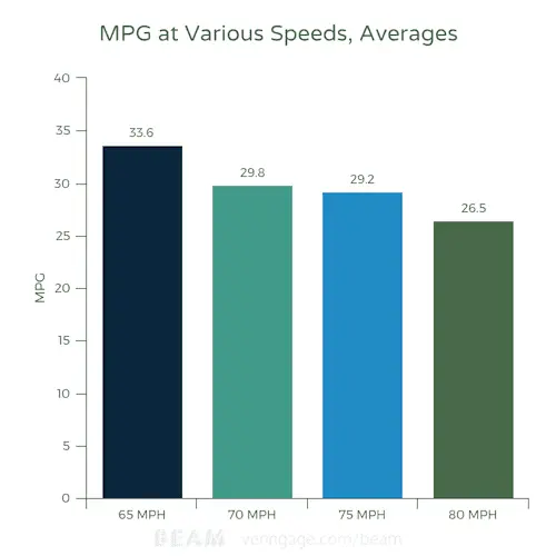

I was curious what effect different speeds would have on the MPG I would get since here in Utah, the urban speed limit is 70 MPH which generally means the lanes vary from <70 to 80 MPH so when there's not congestion, you often can select your desired speed and pick a corresponding lane. Much of Utah even has speed limits of 80 MPH (thank you UDOT, it saves time on road trips!) which means you can go at least 85 MPH without the risk of a ticket. But I limited this test to 80 MPH as there's not a place near by where I could conveniently drive the same stretch with speeds from 65 to 85 without the risk of getting pulled over. What effect does it have if I choose 80 MPH rather than 70?
Results here, details below.
This graph shows the two runs for each speed averaged together:

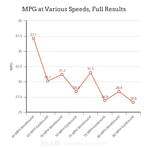

This graph shows each run seperately so you can see if a run looks like an anomaly that's potentially not valid. Personally, the 65 MPH Westbound seems like it MIGHT be too high but possible not. And the 75 MPH Westbound seems like it's probably inaccurate as it's not consistent with the trend seen in all other runs - meaning all the other runs showed a lower MPG with an increase in speed but the 75 MPH Westbound does not as it's MPG is better than the 70 MPH Westbound.
attachment.php
I would like to run this test on a different stretch of freeway and average it together with this run to dilute any variables and therefore get more accurate numbers.
I drove a 5.3 mile stretch of freeway at 65, 70, 75, and 80 MPH. One run each way of the freeway at each speed using cruise control. I measured the MPG using the on-board computer. I tried to keep no cars in front of me to prevent differences in aerodynamics between the test.
I ran the freeway in this order to spread out the two runs at each speed as much possible to minimize the effect of variables in between the speeds:
80 MPH Westbound, 65 MPH Eastbound.
70 MPH Westbound, 75 MPH Eastbound.
65 MPH Westbound, 80 MPH Eastbound
75 MPH Westbound, 70 MPH Eastbound.
The car: 2014 CX-5, FWD, 2.4 engine. 65,500 miles. Fairly aggressive all season tires. OEM roof side rails installed but not the crossbars. Chevron 85 octane gas. Windows up, AC on max with the fan on 3. Headlights on.
Things that happen to not be OEM: Air filter, tires, and the engine oil and filter are whatever Jiffy Lube put in when the previous owner took it there.

Looks like about 2 to 3mpg more than I get at each speed. I have awd.
Good to know. Do you drive much in rain or snow? Before buying mine, I looked at as much data as I could and 3 MPG is difference I guessed between AWD/FWD in my snowy climate. Small enough that I wish had AWD but the private seller market is very limited here and AWD adds about $1200 per Kelly Blue Book so to get one near my budget, I would've had to wait forever till a base trim with higher than average miles was for sell. I didn't want to wait that long so after 2 months I bought a FWD Touring and I love it but still wish I had AWD.
Your 33.6 is inaccurate. Everything else seems +/- .3 or so off from what I see in TX. Ofcourse mine has 10k Miles. The best mpg you will see is around 30/50 mph.

I'm getting pretty much those exact same numbers in my AWD 16 CX5. Actually pretty spot on. I know your data is for FWD though.

See the graph for detail - the 37 is a big outlier. All mpgs reduce with speed but the jump from 37 is really big. Not sure I would trust that number.
33.6 is not higher than what I get - except onsies twosies = never heard anyone with FWD getting 30 or up if doing 70 or more. I beat the combined by a good 2-3 mpg. But 33 is a distant dream. Maybe my tires need to be totally naked or something running 40 psi to even dream of that mpg.

From my experience ('16 FWD, 22,000 miles) I think 37 mpg @ 65 mph is quite possible. It seems the westbound runs are wind/terrain assisted while the eastbound runs are being hindered. To the OP, I'm curious what the conditions were. On a calm day, I can go 70 mph and get 32 - 33 mpg, but a 20 mph headwind will take that down to 29 mpg while a 20 mph tailwind will take it up to 35 or 36. From my point of view, the data point I question is the 70 mph westbound. Looks a bit low to me.
My CX-5 is stock. OE tires have 16,300 miles on them (winter tires have 5,700), tread depth of about 7 or 8/32". 3 oil changes @ 5 K, 12.5 K and 20 K (always Mazda moly). tire pressure at 38 psi.

Yeah, the 37 mpg @ 65 mph data point shouldn't be considered by itself, it should be considered along with the 30.1 mpg @ 65 data point for an average of 33.6 mpg @ 65 mph. The assist/hindrance is terrain. There's a slight elevation loss going westbound.
The conditions were 86F, sunny and the only time I paid attention to the wind was in between runs if I had a red light and I it was only lightly breezy during those times.
