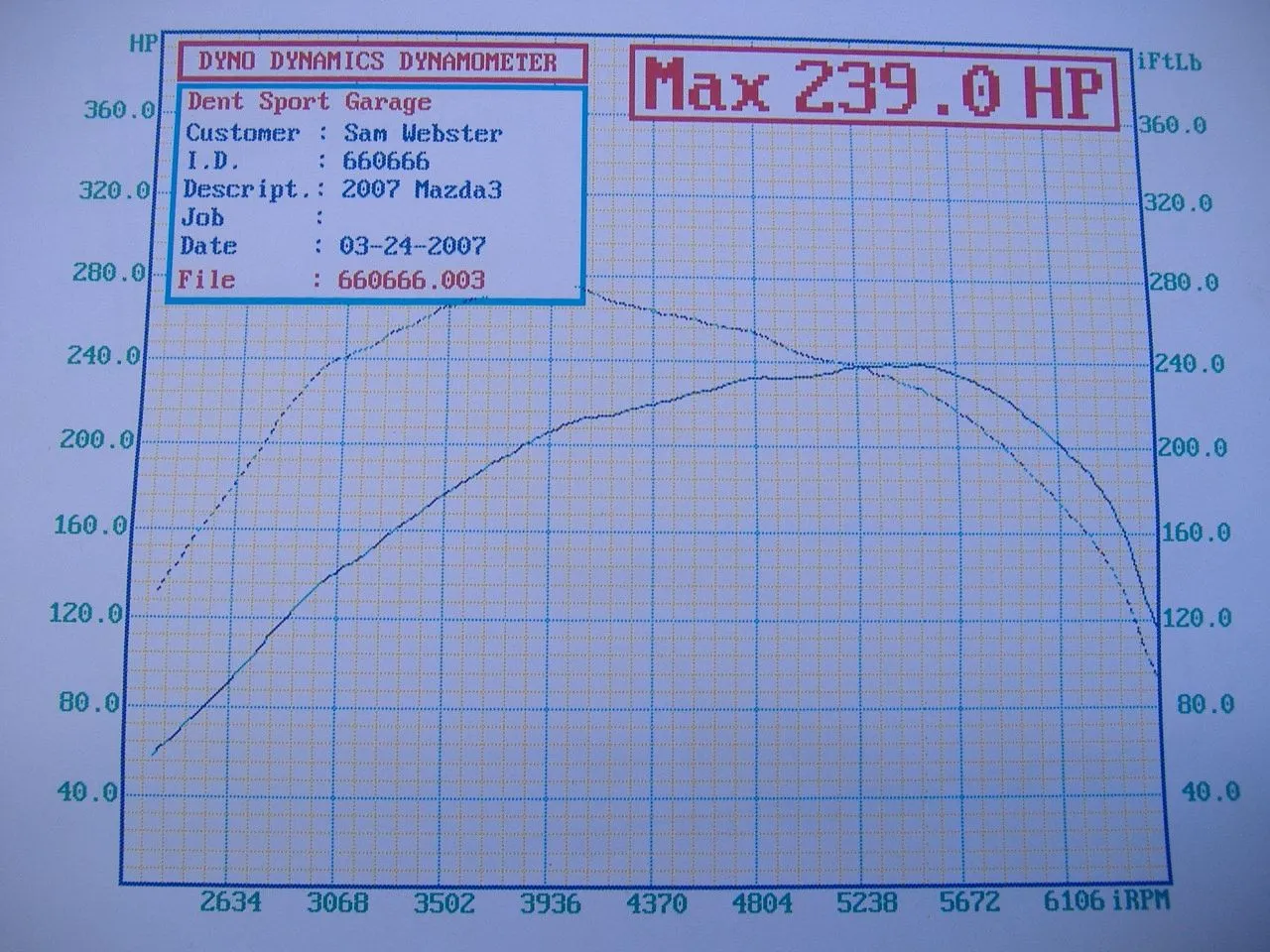

Here is why I went with the MS CAI:
239 whp and 280 wtq. That folks is on a Dynodynamics dyno and would show around 260 whp on a Dynojet. I have not seen any CPE CAI only numbers, they seem to want to include the CBE.

And for whatever its worth, getting consistent numbers out of the SPEED3 is almost impossible. Comparing dyno numbers from different kinds of dynos and cars and locations will only make your decision that much harder. For every dyno you show me where a CAI (I don't care what brand it is) made 25whp, I'll show you another one where the exact same CAI made zero horsepower on another car. Blame it on the e-throttle and this car's fickle behavior in varying weather conditions.

Im also on mnmazda.com Three of us had mazdaspeed3's. One member of ours with a Mazdaspeed CAI and a Turboxs race pipe put down 220whp and 267 wtq on a dyno dynamics. I had a CPE CAI only, I put down 222whp and 257wtq. The last member that ran was completely stock. He put down 213whp and 253wtq.
We had no fan blowing directly on the TMIC, only a fan blowing the radiator, hood open. They set up the dyno for accuracy with tuning, and did no correction factor. Also they explained their exhuast setup isnt the best and they are looking to upgrade. Basically put, he said the cars also read lower because there is less oxygen in their shop than they would like.

If you knew anything about dynos you would know why that is. Each dyno is different. Even location matters. Some shops put in correction factors like crazy just to inflate numbers, some shops have bad dynos etc

Based on the figures you posted of these cars it looks to me as though the CAI's are able to produce about the same amount of horsepower on our cars. So in this case, it seems that the choice of CAI is really personal preference. One thing that's got me curious though is the car with the MS CAI is producing a bit more torque. Could this be because of the Turboxs race pipe???? If that's the case then that combo(not necessarily manufacture combo) seems to be the way to go in my opinion. It'd be really nice to see some tests of stock, CAI, CAI w/race pipe, and cat back on the same car, same dyno, same conditions to get a better feel and understanding of the potential performance gains.
Also, do you have the dyno runs for the three? I'd be interested in seeing the how the hp and torque curves look over the rpm range.
