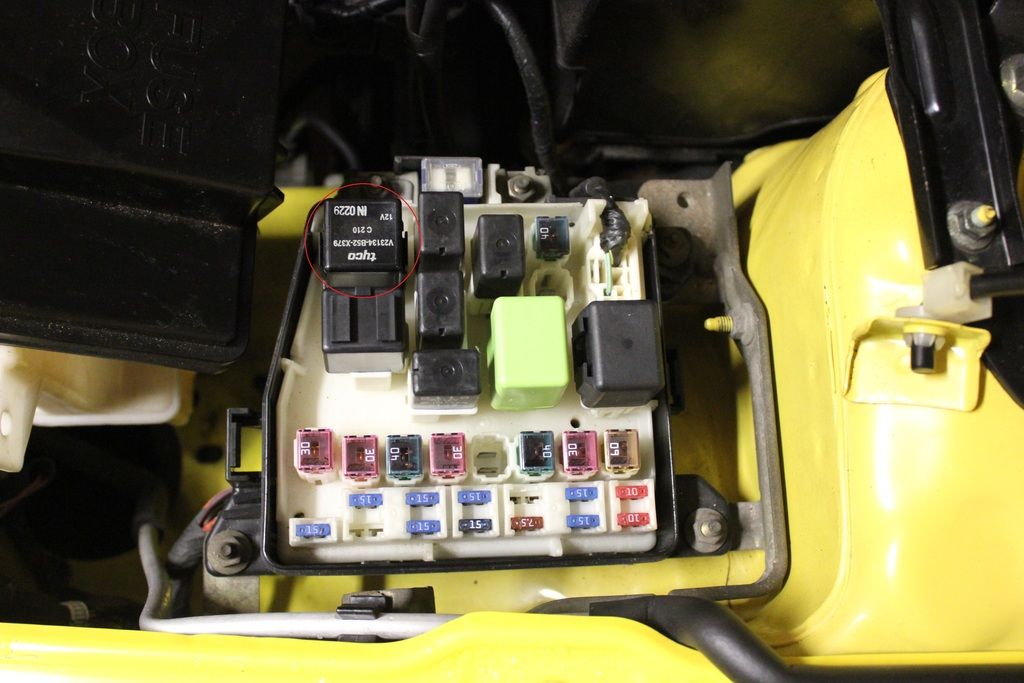

Also, just to make sure. Is this the TNS relay?
I'm thinking your TNS relay if fine because it is switching and feeding power to the tail fuse.
If the TNS relay itself were shorting to ground it would probably blow the 100 amp main fuse.
