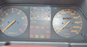

I had a memory of the dash of my parents former ‘87 Mazda 626 LX (purchased new) dash and it had an indicator for tail and stop out. Found a pic online
Bottom left and right lights…
