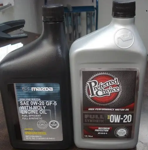

The dealer has it's own brand? What brand would that be, Mazda?
:p
