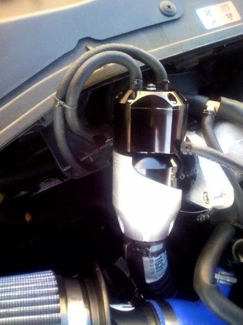

however, i ran into fitment issues with the positioning. i couldnt get the recirc tube to fit comfortably without having the valves twin nipples clear the hood. yes, i can stretch and twist the tube to "make" it fit, but you see that it has too much stress, especially, when you try to position the valve the correct way. so I gave up. didnt even try it out. put it back to stock.
i would love to see some pics on how some people have it on there.
