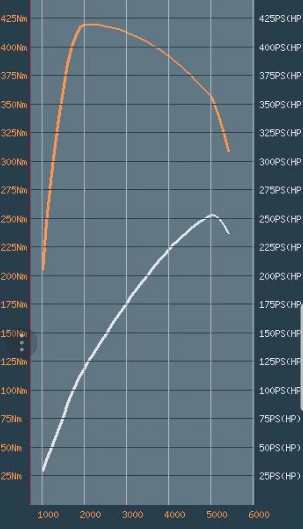

Does anyone know the rev band that the max torque is given over, or is it like the Mazda diesel with a peak point of probably 100 rpm. Most turbo petrol cars I've looked at would have max torque over a wide band, not just a peak reading.
This is all I could find regarding HP/Torque Curve for the 2.5T. Although this was done for a CX-9 it should be the same for the CX-5 since it is the identical motor/trans combo. If this 'manufactured/generated' chart is accurate and assuming 93 octane fuel the 2.5T falls flat on it's face at 5000 RPM. To extract the most out of the engine I would say you rev up to 5200-5300 RPM with the upshift bringing RPM down to 4000.
From the automobile-catalog website; Mazda CX-9 Signature AWD (aut. 6 speed) as offered for the year 2019 for North America
The Horsepower / Torque Curve below was generated by the ProfessCars software, based on the factory data:

Horsepower / Torque values for the curve above:
1000 rpm: 151.7 lb-ft / 28.9 hp
1100 rpm: 181.7 lb-ft / 38 hp
1200 rpm: 208.6 lb-ft / 47.6 hp
1300 rpm: 232.3 lb-ft / 57.5 hp
1400 rpm: 252.9 lb-ft / 67.4 hp
1500 rpm: 270.2 lb-ft / 77.1 hp
1600 rpm: 284.4 lb-ft / 86.6 hp
1700 rpm: 295.5 lb-ft / 95.6 hp
1800 rpm: 303.4 lb-ft / 103.9 hp
1900 rpm: 308.2 lb-ft / 111.4 hp
2000 rpm: 309.7 lb-ft / 117.9 hp
2100 rpm: 309.7 lb-ft / 123.7 hp
2200 rpm: 309.5 lb-ft / 129.6 hp
2300 rpm: 309.3 lb-ft / 135.4 hp
2400 rpm: 308.9 lb-ft / 141.1 hp
2500 rpm: 308.4 lb-ft / 146.7 hp
2600 rpm: 307.8 lb-ft / 152.3 hp
2700 rpm: 307.2 lb-ft / 157.8 hp
2800 rpm: 306.4 lb-ft / 163.3 hp
2900 rpm: 305.5 lb-ft / 168.6 hp
3000 rpm: 304.5 lb-ft / 173.8 hp
3100 rpm: 303.4 lb-ft / 179 hp
3200 rpm: 302.2 lb-ft / 184 hp
3300 rpm: 300.9 lb-ft / 188.9 hp
3400 rpm: 299.5 lb-ft / 193.8 hp
3500 rpm: 297.9 lb-ft / 198.4 hp
3600 rpm: 296.3 lb-ft / 203 hp
3700 rpm: 294.6 lb-ft / 207.4 hp
3800 rpm: 292.8 lb-ft / 211.7 hp
3900 rpm: 290.9 lb-ft / 215.8 hp
4000 rpm: 288.8 lb-ft / 219.8 hp
4100 rpm: 286.7 lb-ft / 223.6 hp
4200 rpm: 284.4 lb-ft / 227.3 hp
4300 rpm: 282.1 lb-ft / 230.8 hp
4400 rpm: 279.6 lb-ft / 234.1 hp
4500 rpm: 277.1 lb-ft / 237.2 hp
4600 rpm: 274.4 lb-ft / 240.2 hp
4700 rpm: 271.6 lb-ft / 242.9 hp
4800 rpm: 268.7 lb-ft / 245.5 hp
4900 rpm: 265.8 lb-ft / 247.8 hp
5000 rpm: 262.7 lb-ft / 249.9 hp
5100 rpm: 256.5 lb-ft / 248.9 hp
5200 rpm: 248.5 lb-ft / 245.9 hp
5300 rpm: 238.9 lb-ft / 240.9 hp
5400 rpm: 227.7 lb-ft / 233.9 hp

Horsepower should peak maybe 4-800rpm prior to redline, depending on how "peaky" it is, and depending on how many gears are in the box. With a 6-speed, and a relatively non-peaky manner, I'd say 800rpm is something I wouldn't complain too much about. I think this is fine. Let's see some real data first (like 0-60, 0-100, 1/4 mile).
So the 310 torque is a peak only like the diesel car, but the petrol drops off a lot quicker, seems strange to me as most other turbo petrol's give max torque over a very wide band.

These numbers show 270 lbft from 1500 RPM to 4700 RPM (3200 RPM Range) Although not very wide it is a lot better range than diesels I'm used to. Yes, Mazda designed this to have a power band for typical use without having to wind it out. It's not going to feel progressive like your typical turbo but then again it makes up for what it doesn't have at the top end with what you get down low. Never going to feel like a rocket and wasn't designed to.
Compared to the NA engine which has only 131 lbft @1500 and get to only 183 lbft @ 4700 the Turbo has twice the torque at 1500 RPM and 50% more torque at 4700 RPM.

Thanks. That is very useful. What I see is that there is lots of torque available from 1200 RPM all the way to 5000 RPM. And there is no point of going beyond 5000 RPM. I wonder what this would look like with 87 octane? Exactly the same up to 4000 RPM and different after?
