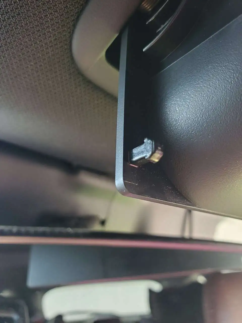

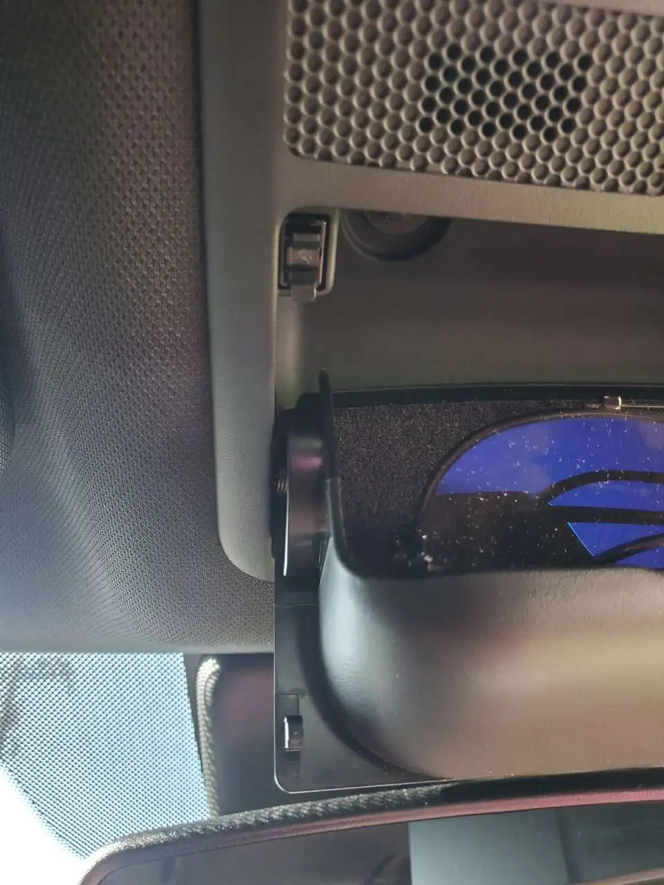

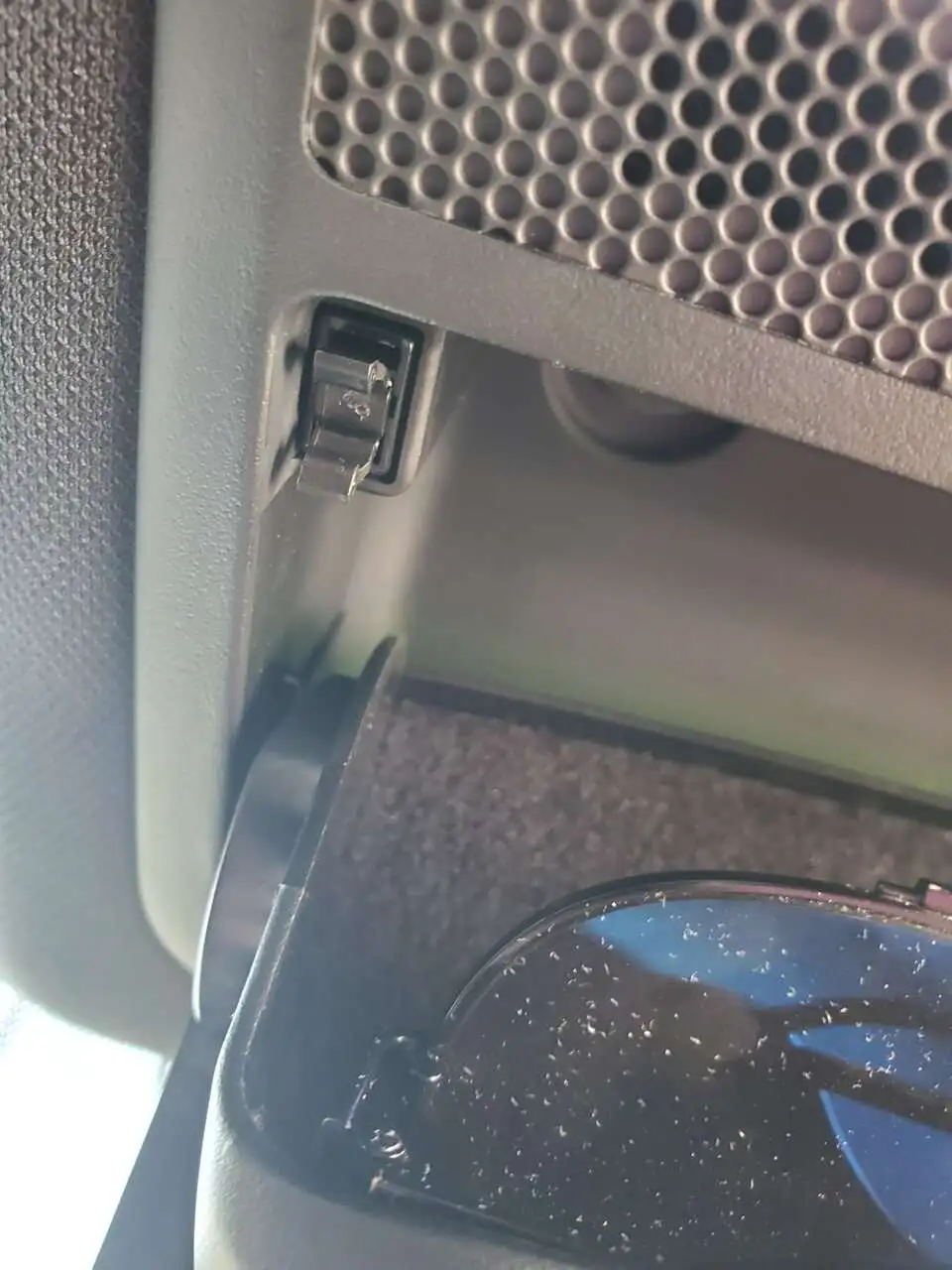

Hope the pictures would help you get it unstuck

Thanks for those photos. I don't remember how that mechanism works, not something I really studied. Good to see that there is a little catch on the edge. Interesting, when I press on the left-side corner it doesn't budge, but the right side corner moves up quite a bit. It's like something is stopping it. Weird. I'll have to play with it some more tomorrow.
Well would you believe my wife got it to open. Turns out all you need is some long nails to kinda pry it open. It seems to work just fine now. Still not sure what caused that, perhaps some moisture got into the mechanism and froze overnight with the temp being significantly less than 0C.
