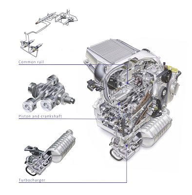

Boxer Diesel Secrets Explained
Exceptionally compact, light and strong
Low friction Boxer balance cancels out vibration
Flat fours low centre-of-gravity boosts handling agility
Punchy throttle response
Common-rail fuel-injection for greater efficiency
Solenoid injectors for compactness
Variable-vane turbocharger mounted under engine for low centre-of-gravity
Highly efficient, fast-warm catalytic converter also mounted under engine

Cancelled Out Vibration
The 2.0 litre Boxer Diesel has a class-leading light weight with the horizontally-opposed pistons effectively cancelling out the secondary harmonic vibration (vibration with twice the frequencies of the engine speed).
The crankshaft is short and highly rigid, minimising the vibrational noise of many diesel engines.
And the superior balance of the horizontally-opposed engine means internal rotational inertia and friction are drastically reduced compared with an in-line engine.
Reduced internal friction means throttle response is exceptionally lively and in keeping with Subarus sporty heritage.
Compared to Subarus 2.0 litre engine fitted to the Impreza, Legacy and Forester, the 2.0 litre Boxer Diesel has a 11 mm longer stroke and 6 mm smaller bore for a capacity of 1,998 cc versus 1,994 cc.
Even More Compact
Thanks to a bore pitch shortened from 113 mm to 98.4 mm, the overall engine block length is only 353.5 mm compared to the petrols already compact 414.8 mm.
The block is of a rigid semi-closed deck design, while all five main bearings in the alloy cylinder block use metal composite supports for added strength and durability. It also enhances refinement, providing a similar thermal expansion to that of the crankshaft.
Extra water-cooling slits have been added between the cylinder bores and the high-strength pistons are squirted with oil to enhance cooling. The large ends of the connecting rods feature an asymmetrical profile for assembly precision and reduced friction.
The high-strength crankshaft has a special surface treatment to withstand the diesel engines high combustion pressures while the uprated cylinder heads have roller rocker arms. In addition, the cam-drive is via a chain system that better handles the variations in torque of a diesel engine.
Advanced Fuel-Injection And Turbocharger
The new Boxer Diesel uses an advanced common-rail fuel-injection system with the fuel being pressurised at 180 MPa before being fed into the common rail. This maximises efficiency, both in terms of power, fuel consumption and emissions.
Special, short-length solenoid injectors ensure the engines width is no greater than that of the 2.0 litre boxer petrol unit, despite the diesels longer piston stroke.
The variable nozzle turbocharger ensures the correct boost throughout the engines rev-range and its low centre-of gravity position under the engine and close to the catalytic converters increases environmental performance.
The Boxer Diesel meets Euro4 emission standards thanks to oxidation catalytic converters, a particulate filter and exhaust gas recirculation. It is the most environmentally-friendly vehicle in the AWD passenger car class.
