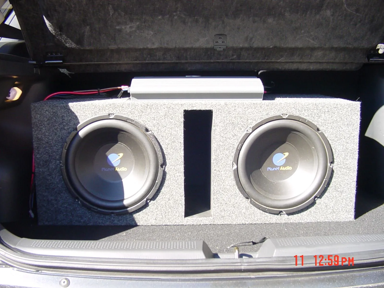

i just ended up getting a vented box that looks pretty nice! just need to do a lil floor mod so the wires don't make the floor stick up!
and it didnt so i will attach them.....
When you manage your files in the "user cp" there will be a http:// link (after you upload the picture). You copy that link. Then when you are typing up the message the "IMG" button above where you type is where you paste the link. hopefully that makes sense.
is that the r/t or obcon vented box? sure looks like it. if it is, good choice, it's a pretty well built, low tuned box, which is rare for prefab boxes;)
