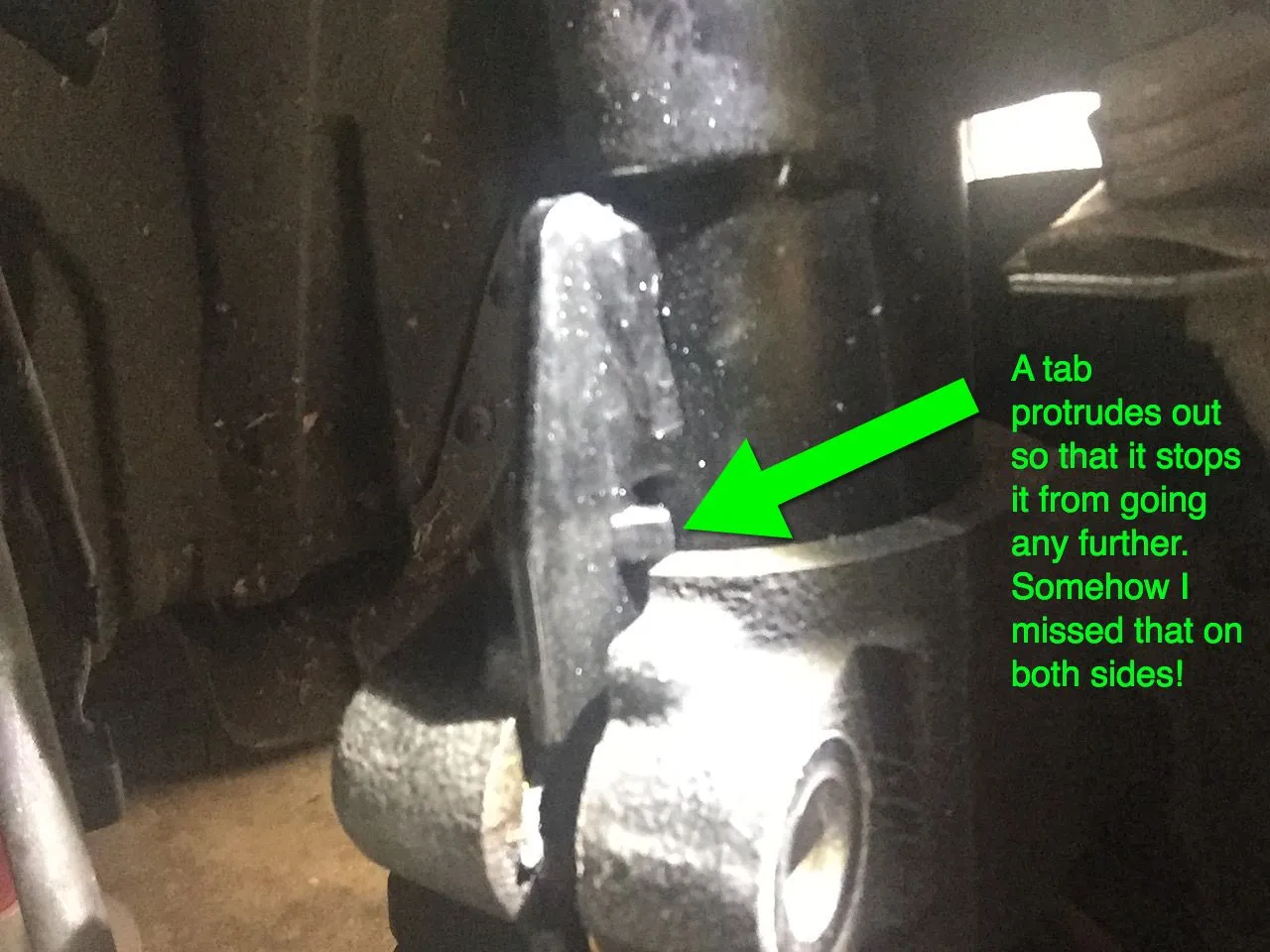

Struts blown at 85,000 miles ?
Here's a pic to show what I'm talking about.
One thing I did noticed was the total strut length on both of the bilstein's was longer too. Like almost 3 inches longer! I initially thought maybe my original struts had lost some of the length due to age (118,000 miles). I checked the ride height of my sisters car (same year and model and age, different tires and only 55,000 miles). Measure from ground to the bottom of the front bumper, her's was 8.5 inches. Mine is almost 9.75 inches. So definitely higher. I slid my low profile jack under and it definitely has more room.
I can't recall how far the original strut was in the knuckle but pretty sure it wasn't all the way in since there was some rust at the bottom of the knuckle and I sanded it to hopefully have it slide in easier (I did not sand enough). I stuck my finger in the bottom of knuckle (approx 1 inch) and it seems the bilstein was at approx the same depth into the knuckle as my original.

I contacted Bilstein and they were prompt to answer my email. They said the following:
"Before disassembly we do always recommend to take some measurements from the bottom of the spring seat to the top of the steering knuckle. This will provide an accurate measurement for reference for reassembly for the new shock. The shock should be installed into the knuckle far enough that the tab should stop before it comes into contact with the knuckle pinch bolt."
I missed seeing the tab! I also did buy one of those knuckle spreaders just to make it easier on myself. Glad I got one before I did the job. I had to stick three pennies to try and get it to spreader wider. I went one penny at a time and the third one did the trick and the strut slid into place (I had a jack under it to put some weight on it.
Glad I corrected it and the ride height is now .75 inch less with the strut deeper into the knuckle. The rubbing is unfortunately still there. Its probably the moog end links. I'll have to think what else I can do (aside from switching out the end links).
