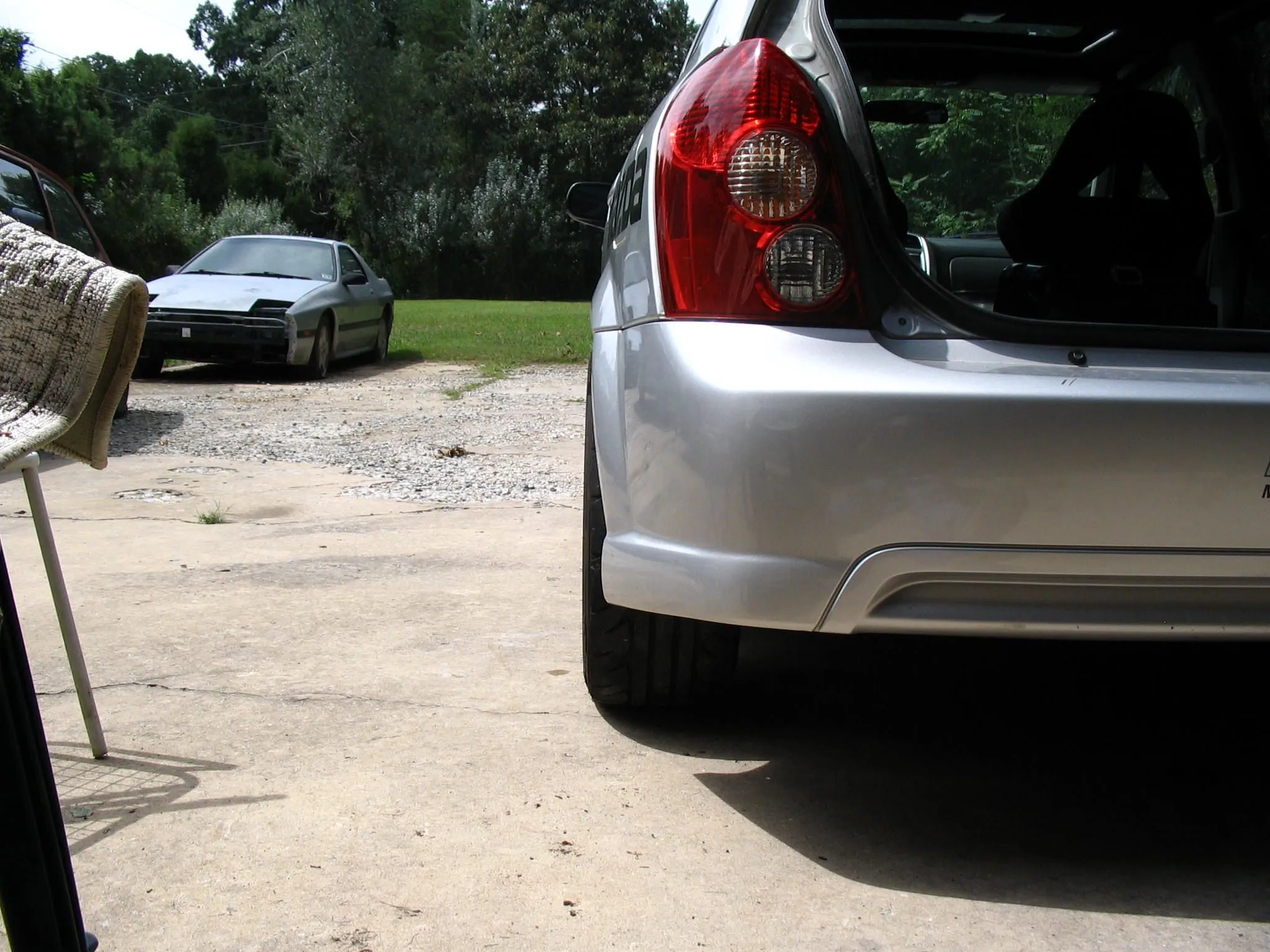

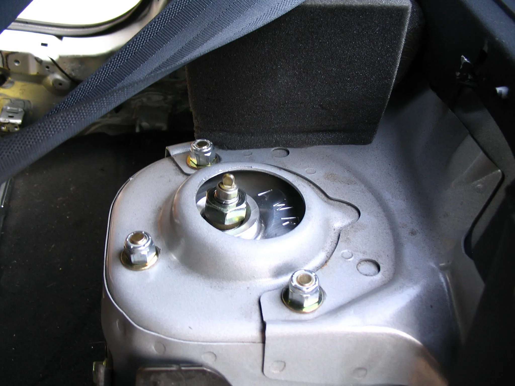

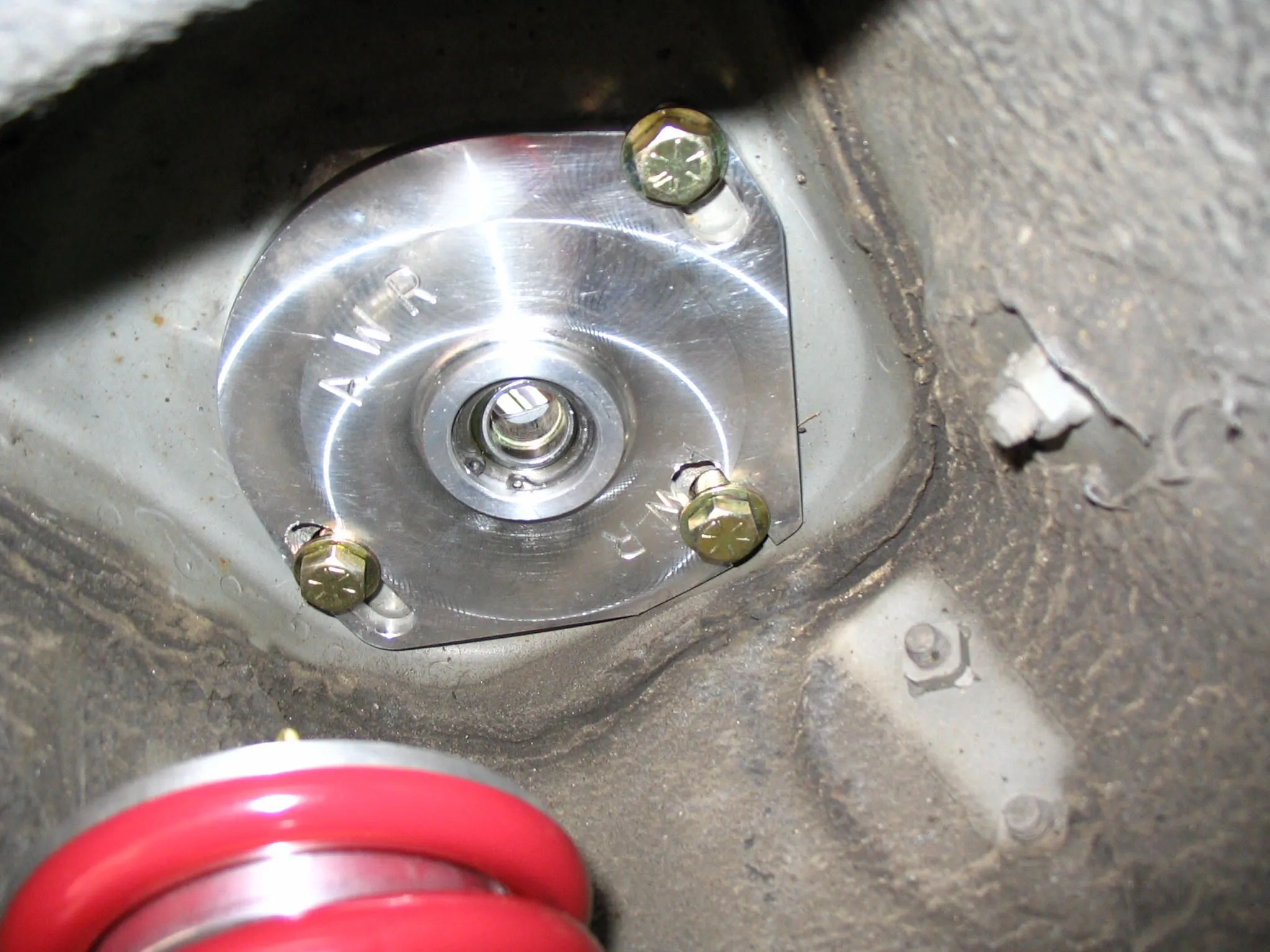

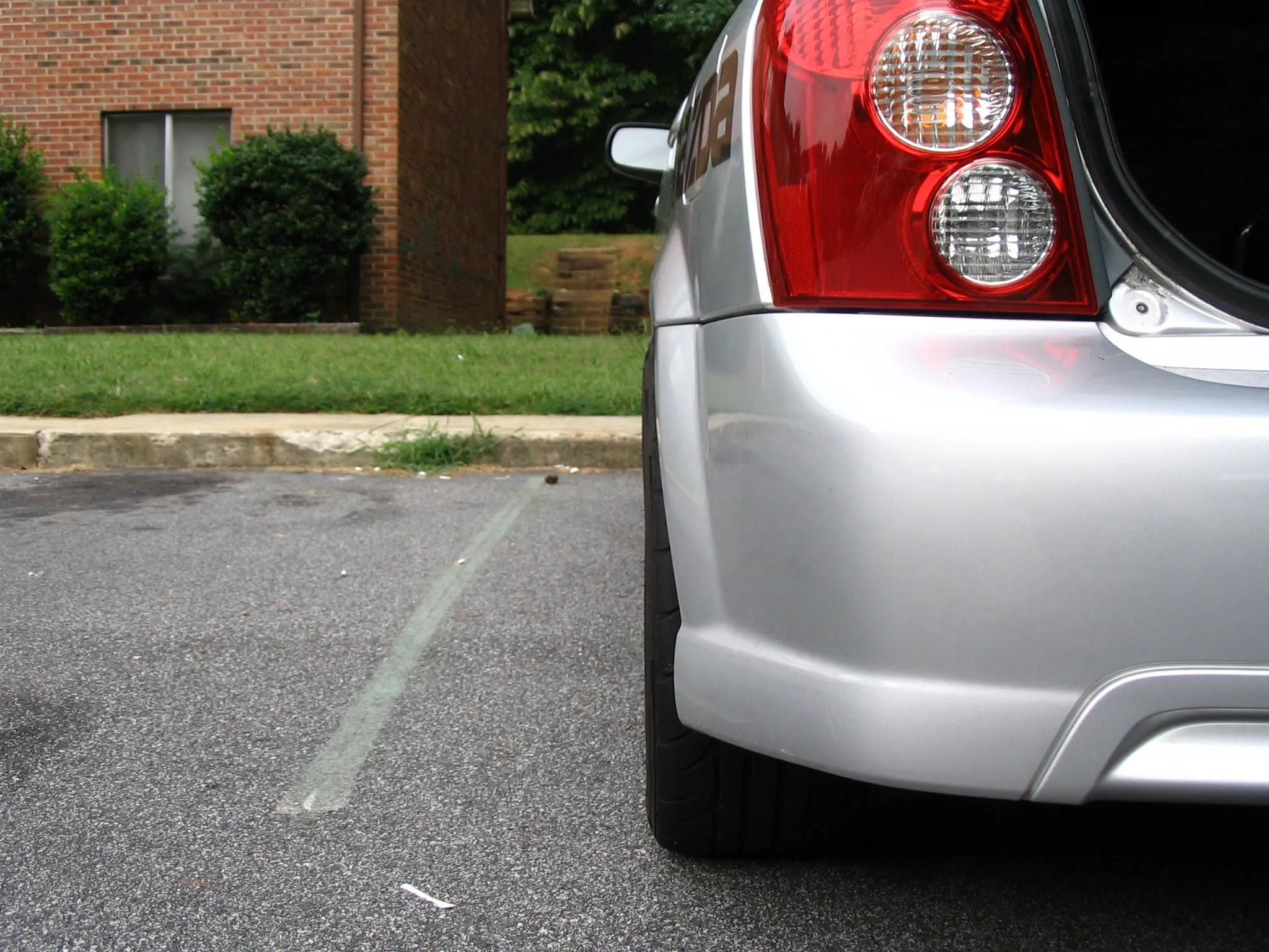

The first picture is showing the lack of camber in the rear from installing the AWR rear plates unmodified. The next picture just shows the camber plate where I made the slots 1/2" longer and trimed off where it was hitting the strut tower. The third picture showes the top nut on the struts. I couldn't take much more off the camber plates before I would be unable to get a socket on the top nut. The last picture is the current rear camber...just shy of -1 degree. Looks like I'll have to get a set of lateral links to gain some more rear camber. I can't use bolts because my tire-strut clearence is only a few millimeters.
