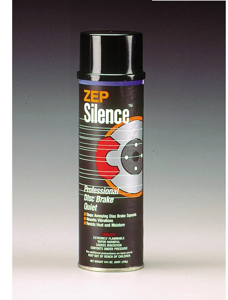

it is the pad moving in the caliper. I threw a liberal amount of brake-quiet on there (the grease you get free or for .99 from the parts store when you buy pads) and it left.
Brake glue
if you think your pads are dragging on your rotors,(especially intermintently) spray glue for brakes will make them retract much better
