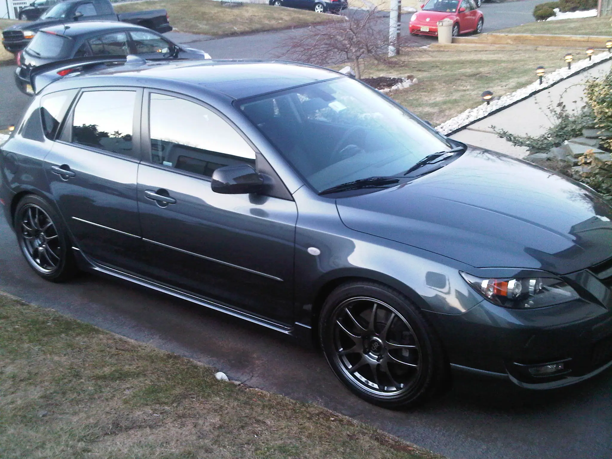

hey guys i dunno much about cars (huh) and i just got my torques in hyperblack 18x8 +48 on my MGM dropped on pro kit. no tires yet tho.. im wondering if i could use my stock tires for it without having any issues.... if not what tire specs should i get.. thanks!
update: got the rims installed last wednesday. hopefully there's no more snow storm in jersey..here's what it looks like..

235/40 would be your best bet and would keep you at almost the same diameter as stock.

i see but do you know if stock tires would be stretched that badly if i decide to put it on?

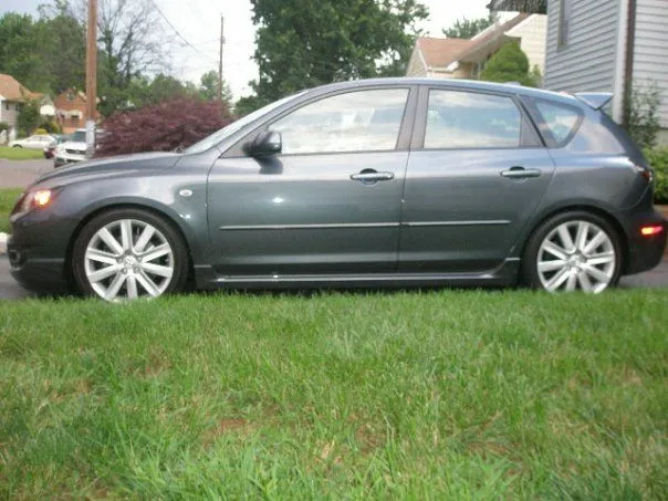

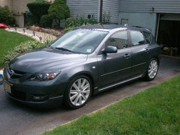

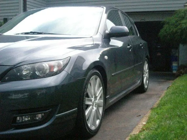

Pics are from a year ago. after my buddy installed the pro kit..

I was originally going with the same wheels as you and I spoke to a rep at Rota, Discounttire, and Wheeldude and they all confirmed the stock tires will work. They will stretch a little bit, but not enough to cause a problem. I'm assuming your stock tire size are the same as the second gen? 225/40/18
Btw, that drop looks really nice. Did you go with the full prokit or just the springs? I was going with 1st gen H&Rs on mine but I may look into the prokit.
thanks man.. i just got the springs to make it look less like a wagon/family car! lol.. not really looking to spend much for it. and yeah i think gen1 tire specs are 215/45 so im kinda hesitant.

Honestly, I'd call up DiscountTire in the morning and explain the situation. They will tell you for sure what sort of problems if any you'll have. Good luck and keep us posted.
The stock 215-45's will work fine, in fact I ran them all summer last year..the biggest problem is no rim protection so stay away from the curbs! They will have a nice stretch but its not out of spec for the tire.... 235-40 is the perfect tire for your set up tho.

Word of caution - many members are reporting that they rub with 235/40's on a drop. Your wheels would sit 4.5 mm closer to the fender as well. After you wear through your stockers, my recommendation would be to do 225/40 or 225/45 if you want a bit more protection against the Jersey roads. 225/45 might rub a little, but as long as you haven't cut your bump stops you "should" be OK.

As long as he doesn't go with something like a Falken Azenis RT-615 or Dunlop Direzza etc... 235-40 should be fine especially in an all season tire, just get the specs of the tire from the manufacturers web site and check the section and tread widths.

That's what i had in mind at first 225/40 or 45 but i kinda like the idea of having a wider tire but not the hassle of rubbing/rolling fenders.. i would definitely look into that tire specs with either 40 or 45 if 235's are a bit pushy with the drop.. but thanks for the input..
