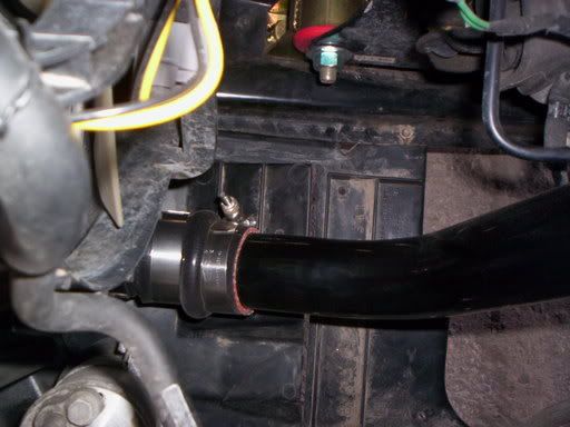

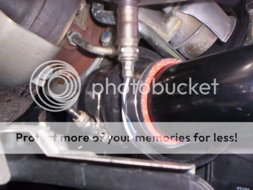

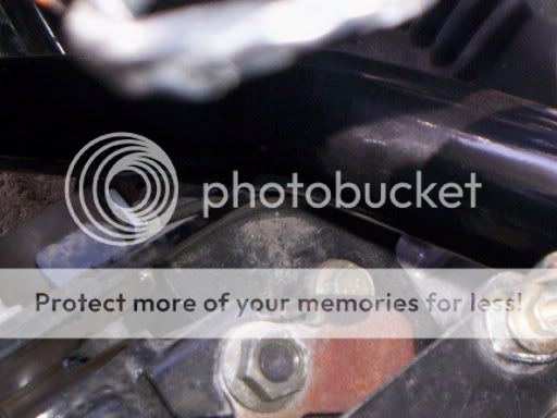

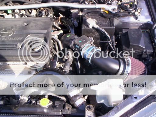

I really don't understand your problems. I installed the whole kit a few weeks ago and everything is A OK.
The stock BPV is a little higher that with the stock pipe. So what. It fits nice and works good too. No problems there.
Fitment is tight in some areas, but no so tight that you cant install them. For the tranny mount problem, yes I give it to you, it does rub a bit. But by the way I look at it, it touches barely that I really dont think it will wear through. I'll keep an eye one it though. If it does seem like it's going too far, I'll shave a bit of metal on my tranny mount.
For the silicone hoses. Use a bit of motor oil around them. They will fit like in a girls "/&"/$"$?% (boobs2).
Finally, I love them. Good workmanship. I'm not saying that they are super easy to install, but I'm not even a mecanic and everything went fine.
Oh yeah, and from what I know they are the only pipes that you can still use the stock intake box with. Good for me in winter, because with a SRI or CAI our cars hit fuel cut.

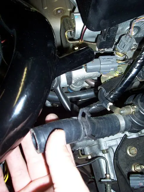

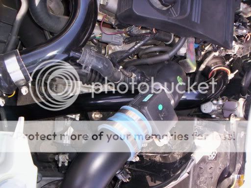

for those who don't know...I do installs and custom fabrication here in alabama. A guy asked me for custom hardpipes for his msp. I told him to order these pipes. He gave me the money, I bought these pipes. They showed up eventually (after being delayed). I drove over an hour (each way) out to the customers house to install these. The fitment is WAY off. I'm not just some kid with a wrench who doesn't have any experience with this stuff. I'm an ase certified mechanic whos designed his own custom MSP exhausts and 2.0L supercharger kits for the protege not to mention turbo kits for the 2.3L ford 4cyls. I know what I'm doing. I've done a few FMIC installs on proteges before without any problems like this.
When I placed the upper pipe flat on top of the turbos outlet the piece that goes into the IC id over to the right about 2"'s too far. Also, the nipple for the bypass is pointing in the wrong direction causing such an extreme bend on the hose that pinches the flow off. I didn't get any pics of the bottom pipe but to further explain it, we placed the reducer on the TB and slid the pipe in without clamps to test-fit everything. the pipe laid firmly against the tranny mount and only .1-.2" away from the IC outlet. There is no room to move the pipe to even get the other hose on there because it's pressing so hard against the tranny mouont already.
This is simply a case of a bender who didn't take their time and do this correct the first time and now it's causing me major problems with my customers.
notice in the pics I post that the bypass tube is NOWEHERE near where it needs to be to fit properly and the outlet side of the top is WAY off from the IC. Both pictures were taken with the top pipe placed directly on top of the turbo outlet in it's correct postion.

wow, looks like you got a bad batch...maybe its hit and miss not a good thing to have if you are the maker of these....but hell i still want the hot pipe IC pipe....from someone!!!
