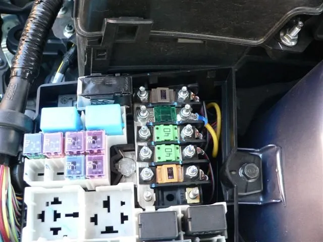

I connected my power wire up as shown in the pic. You need a "midi" fuse and a couple of M5 nuts. Connecting to the battery works fine, but this is cleaner and safer.
