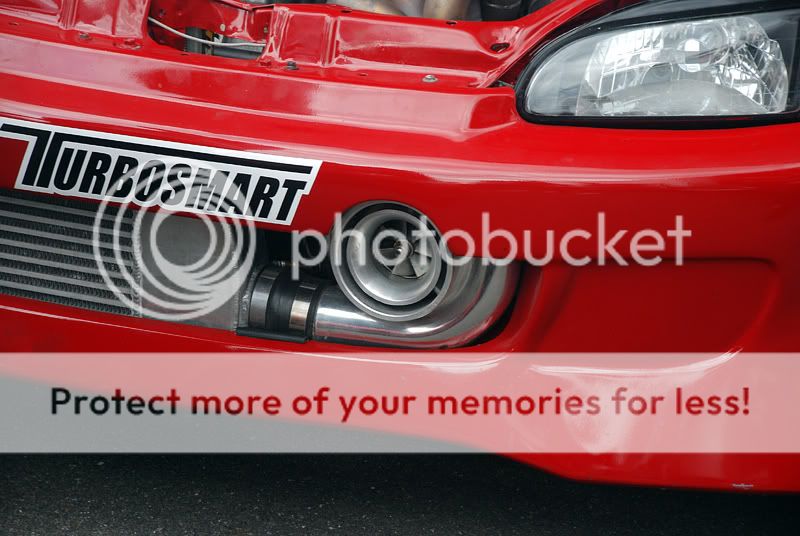

if you're gonna have your turbo like that I'd be trailering it to the track haha. Turbos don't like bugs and rocks.
