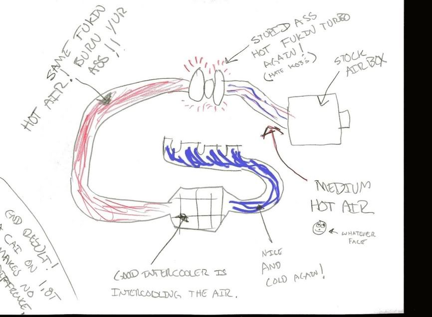

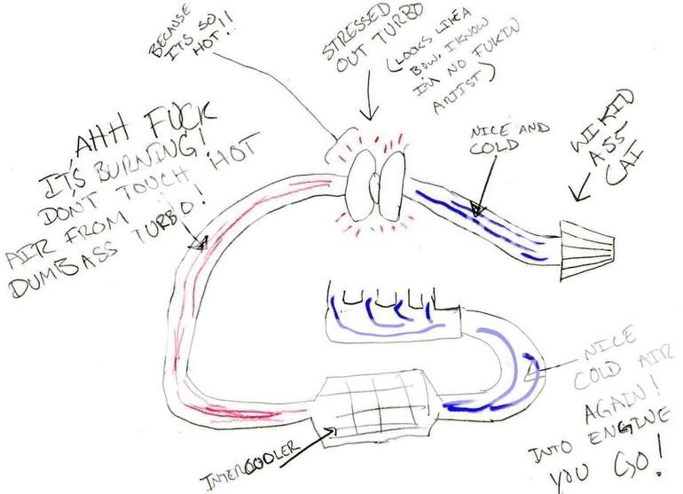

pictures are worth a million words...cai are worth less SRI>CAI
pictures off vortex, but it will work here as well
CAI
Stock air box
so basically, according to that well drawn diagram, don't waste my money on CAI? and instead save it for an upgraded intercooler? (drive2)
man, cant you read...it said "good intercooler is intercooling the air"(chair)
jk, its your choice. dont bag on the well drawn diagram. its the only proof we have that SRI is better than a CAI (rofl2)
