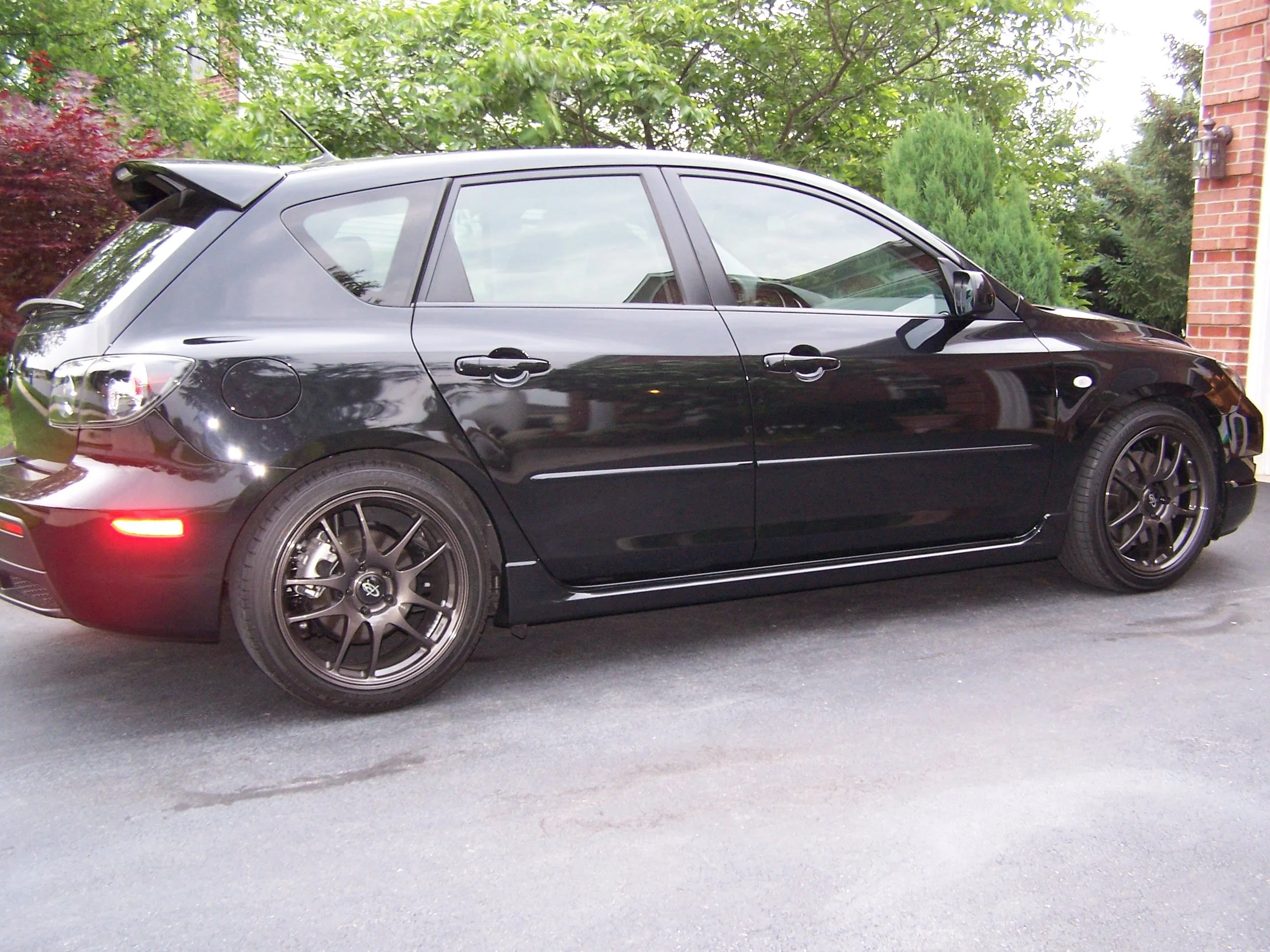

Do you have any wheel gap in the rear?
Here it is with the stock tires 215/45/18. I need to get some 225/40's when these wear out.
