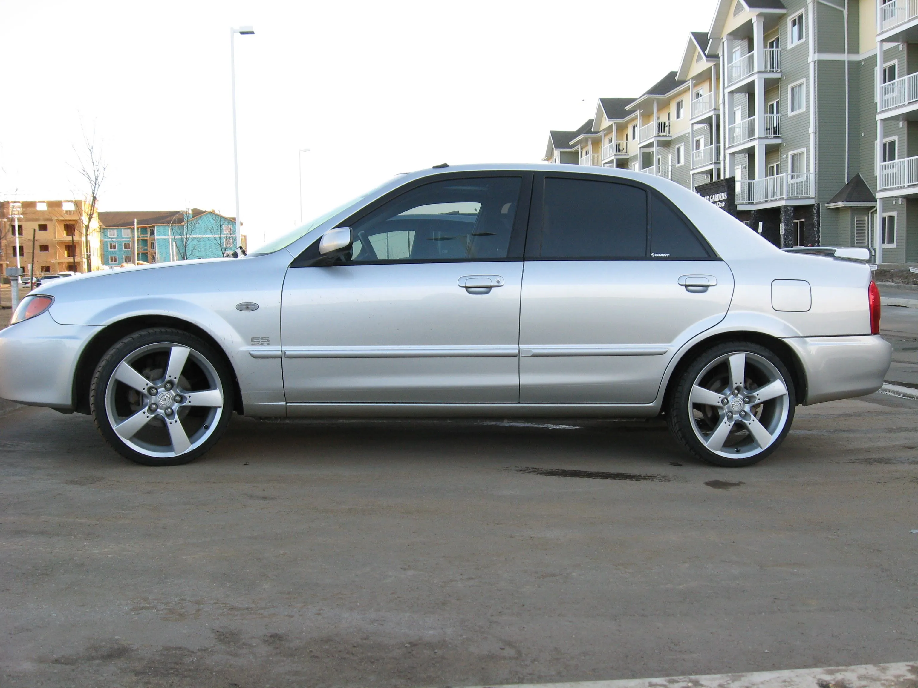

lol! thats what my endlinks looked like too.............after i took a saw to them...the end result is great though! Before and after.....yeah i know....need side skirts
