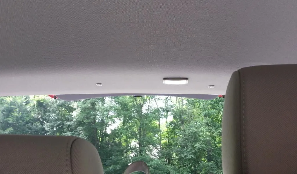

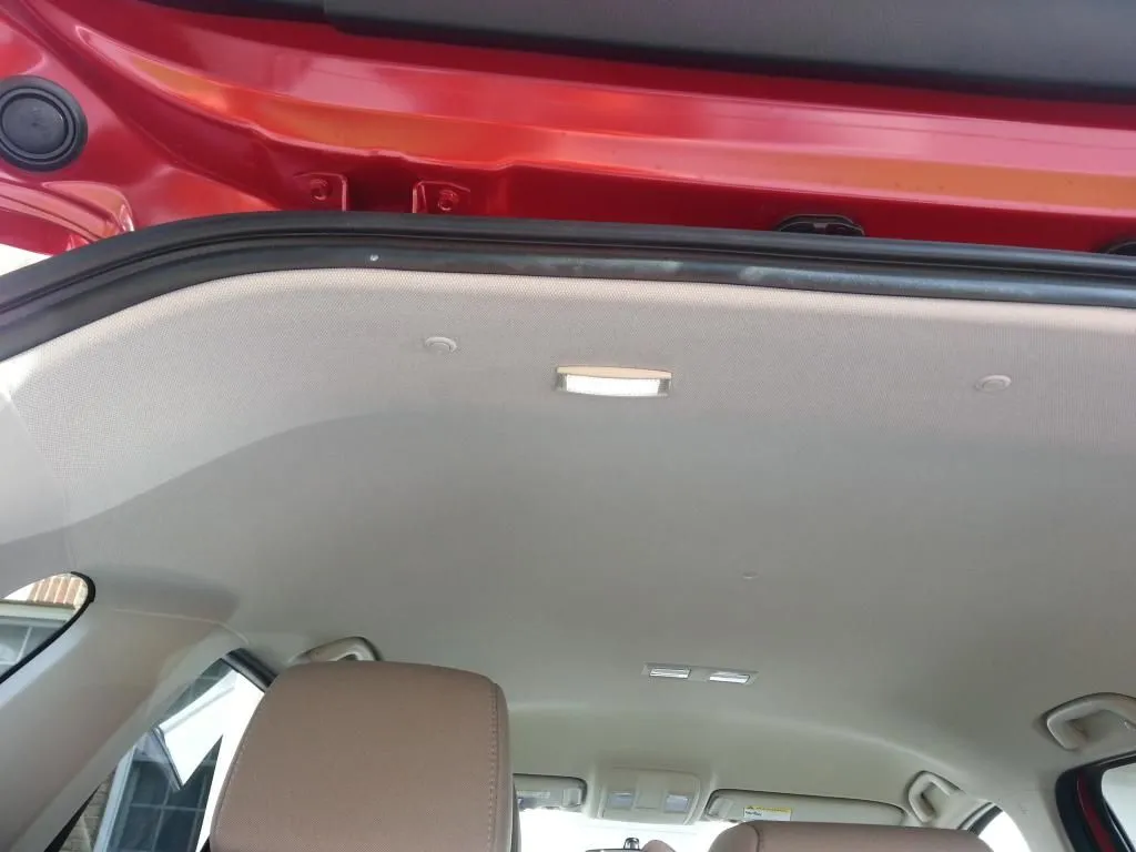

That was too easy. Now, feel free to include the details of the part you use and how you wired it (crimped to factory hatch light I assume).
Dang!
OK, well it's a sunvisor light from a scrapyard VW that was mounted in the headliner above/behind the sunvisors (I think this was from a Passat, but many VW's have them). Cost me $5 from the local You-pull-it, but you can get them - albeit, more expensive - off eBay. here's an example: http://rover.ebay.com/rover/1/711-5...2&toolid=10001&campid=&icep_item=130822597048

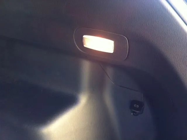

It's placed over at the side, because that's where there's space above the Mazda's headliner with a cutout where the wires are routed into the rear door. And yes, I simply extended the wires and ran them across and down & attached them to the wires supplying the side trunk light.
I also replaced the old festoon bulb in the VW light (which is quite dim) for a couple of strips of 5050 LEDs.

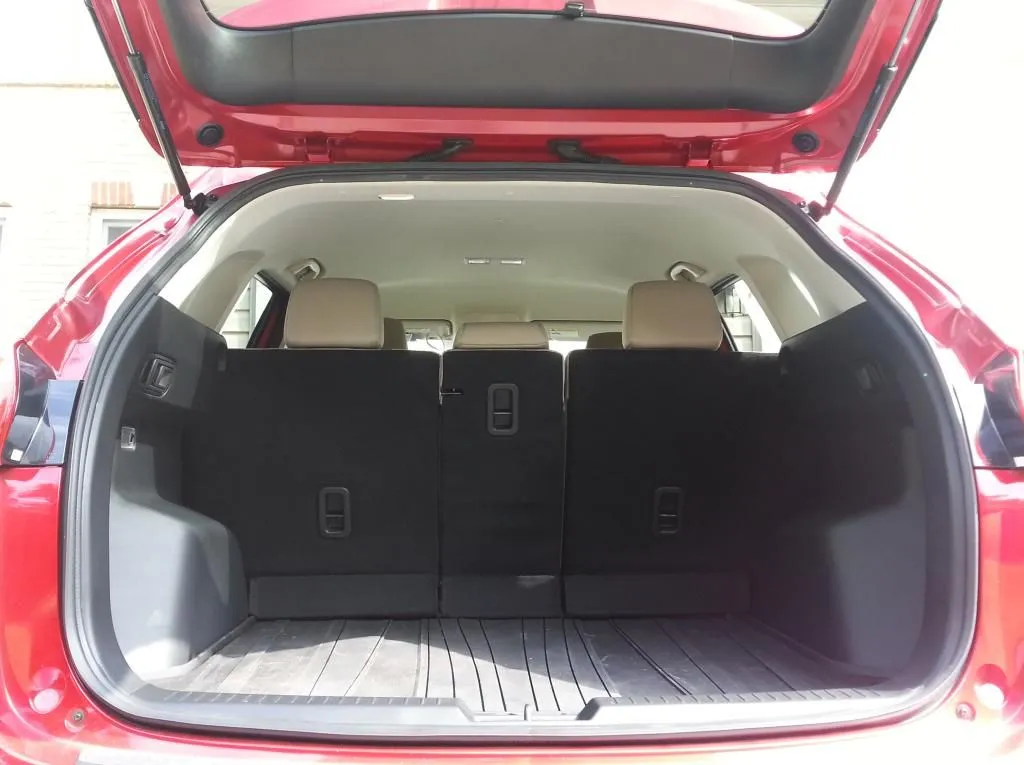

More photos:
attachment.php
attachment.php
I should add... there another type of VW dome light that looks very similar to this, but has a built in switch. DO NOT get this type. It's larger, and most importantly, deeper, so will not fit.

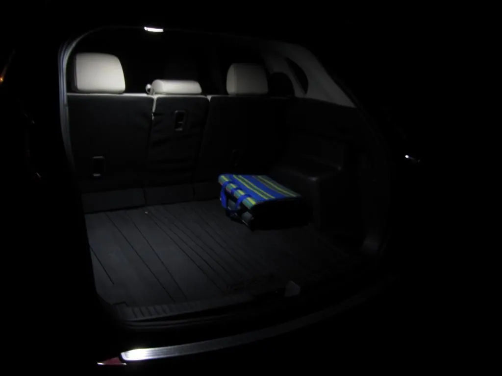

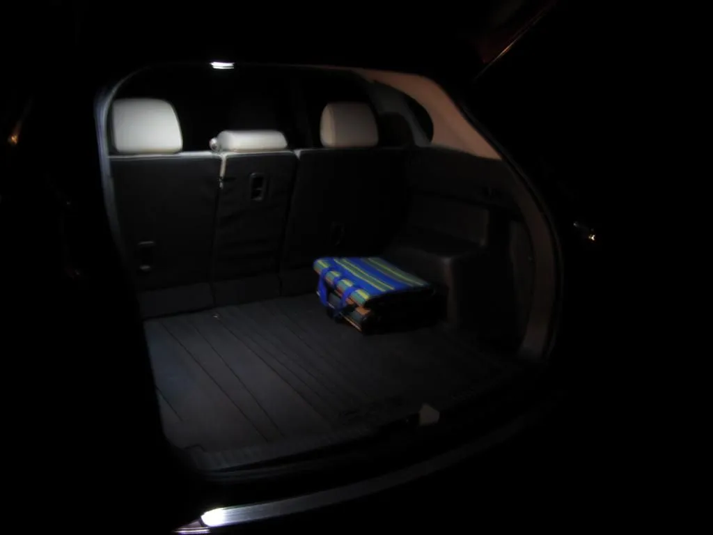

Your wish... I just went out to take these. First with the factory (side) light OFF, then with it ON:

So u ran the wires Down and hooked up to white-ground and that blue/red wire? That is what is in the trunk light wires. Also do it with battery disconnected.
